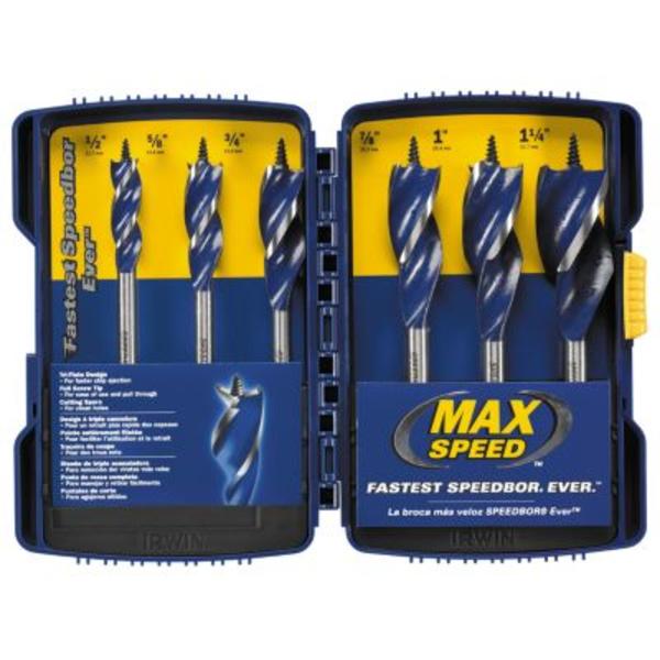

these ones on a 1/4 hex impact driver do great in wood
prod_1640624812
