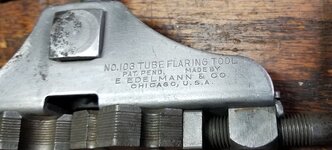

Good evening gentlemen and possibly ladies. I was wondering if anyone had an idea of a part number for this flaring tool. It's marked IMPERIAL BRASS-CHICAGO. I can make out the patent number (NO. 1724697) but I don't see any other numbers. It looks like it's been engraved free-hand on the back side, USAAF, so possibly pre Department of Defense era. Maybe not. The reason I ask is because it is the best type I've ever gotten results with and would like to find my Dad one but haven't been able to find anything pictures or otherwise. I did find patent page but no further. Any information at all I'd great appreciate. Thank you all. Great discussions here.

I'm not sure the clamping mechanism on your example is critical here. Various examples sans clamp are available on EBay, of course; new versions are readily available on Amazon. https://www.amazon.com/Imperial-Tool-195FC-Degree-Flaring/dp/B001HWBYEG?tag=atomicindus08-20

That's a cool clamping system! Never seen it before.
My Imperial Brass is just your standard, everyday screw clamp:
But it's still the best flaring tool I've ever used.
Nice to see that yours is the apparently original red paint. I wasn't sure on mine and now I can repaint it.
31,008
The only flaring tool I have seen with that quick clamp was... yours! When you posted here back in 2021. :)
That is a very odd-looking flaring tool!
I have several, including a wartime Imperial Brass. It has two large wingnuts for clamping the die together, and the screw-type anvil, which slides on or off. It doesn't have that handle affixed to the anvil. What does that handle do when you turn it? I'm curious about the purpose. Is that a cam action tighten and quick release? (EDIT: I'm guessing that's what it does. Instead of threaded bolts and wingnuts, you just move that handle to tighten the die halves together or release them. Pretty nifty.)
On the patents, Imperial Brass stamped the heck out of their dies with their patent numbers. The wartime dies have several patent numbers on them, as late as 2,370,089, which is 1945. You will also see them with in between wartime patents 2,226,852 and 2,242,831, back to 2,072,559 (which dates to 1937). Yours with a 1,724,697 patent (1929!) precedes all those.
Very cool find.
I still can't help you with a model number. 93-F was the number of their standard model kits in the 30's and 40's. While I love the idea of the quick clamp and release on that odd model, I'd have to agree with @LopezBart that the action on the anvil is the same on the other, standard model. I have a few extras I could be talked into letting go, including an Imperial Brass or two. :)

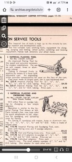

Thanks for the link! I searched thru it and my No. 125-F Kit is not listed.
That was for Andy, Larry. As I recommended, I would look through 60's catalogs. Especially with that "1959" date stamp on the dies. And I just noted that the box on your label is actually Imperial-Eastman, not Imperial-Brass. So definitely after 1961, when they merged.

Andy @alinc100 tagging you in case that link was too subtle. Your double-flare tool (adapters built in to that revolving part so you don't lose them) is on that page, top right.
Yeah , I see it in the catalog. Still unsure how exactly it works. I might have to buy some tubing some day and just practice. I really haven't looked at it much, it's more like a fidgit spinner for me than a needed tool.
