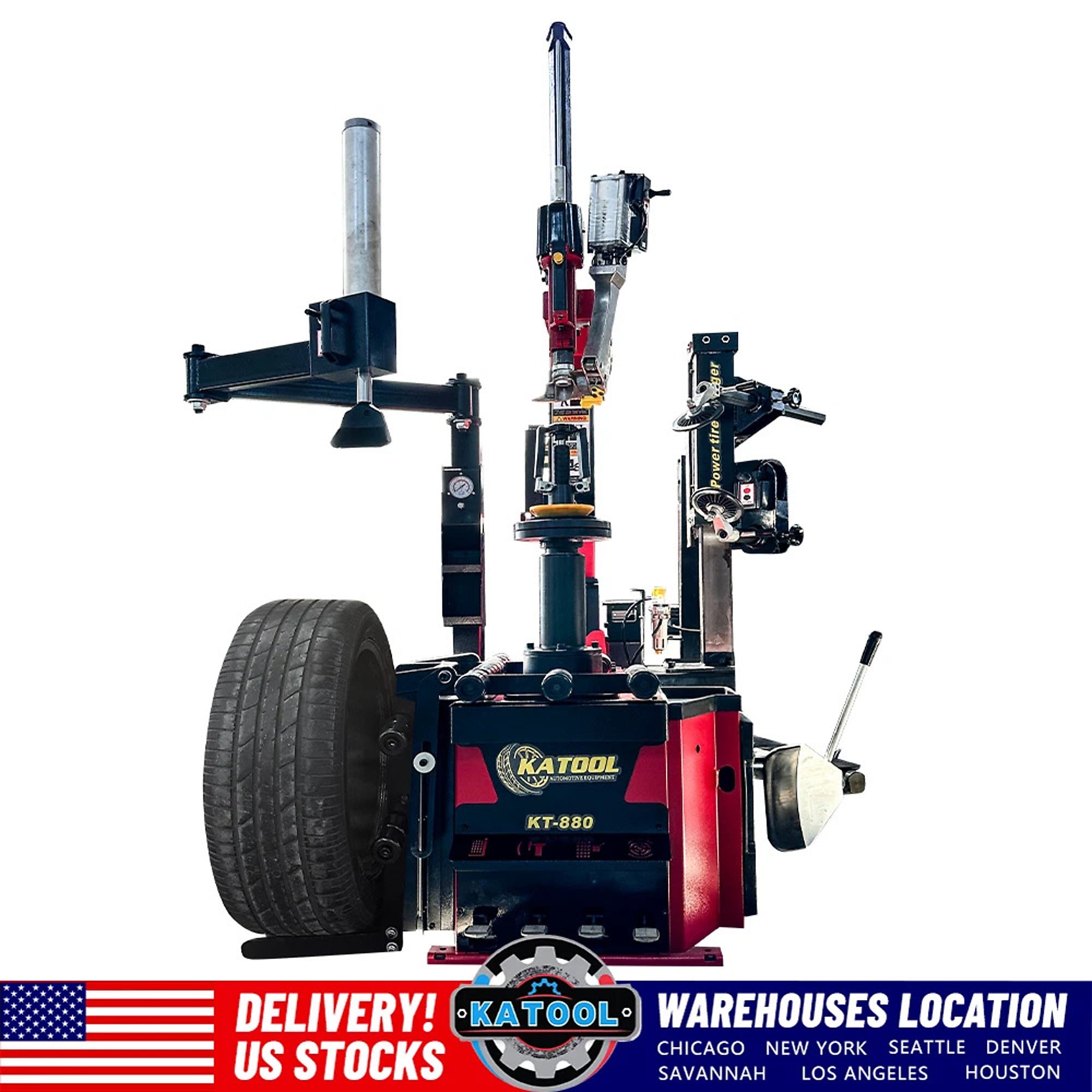

Minor update on the tire machine & balancer combo. I am heavily leaning towards Katool as noted above.
However, I changed my mind on which combination to get. Now I'm eyeing the same KT-T830 tire machine, but with the KT-B750 balancer. The fancier balancer is quite a bit more, but has some features I think would be very useful.
First, it has the auto-width select, where you slide a thingy out of the balancer and touch it to the side of the wheel, and the balancer reads this automatically. The cheaper balancer requires you to enter the numbers manually using up/down arrows.​
Second, the fancy balancer has a laser guide to show where to apply the weights, in theory making the weight application slightly more foolproof. I like this a lot.​
This pair is $2600 / OBO, erasing the savings vs Vevor, but is a significant upgrade for basically the same price. I'm going to use the "Make Offer" option for grins, worst that can happen is they'll decline.
Oddly, while I was finally able to find dimensions for the tire machine, I cannot find exact dimensions for the balancer. Same as @ctandc72 I don't have room in my shop, and it's going to be a Jenga/Tetris adventure to stuff them in somewhere. Really wish Katool would have the same drawing for the balancer, as provided for the tire machine (see below).

Those "features" are only useful if you hire people to work the machines for you. None of my 3 balancers have those features... nor would I really fimd much value in them. Especially not $600 worth!

If your doing any kind of "nice" rims, I wouldn't do rim clamp. You either have "knubs' that dig into inside of rim or you have to use plastic covers that hold lower edge of rim, which sometimes slip with harder to install tires (and sometimes if it slips far enough, you trash a TPMS).
Also, they can be a PIA beading up, since you have to remove to seat lower bead and sometimes you really have to jerk a tire around to get both beads seated (like some larger truck tires that have sat for a while, and beads "****" towards each other, don't want to get anywhere near seated). I guess if only doing std pass car tires, won't matter much or could get bead blast canister down the road.
One other option if/when is center post adapter kit. Spendy, but allow use with nice wheels, never slips, and not in the way seating lower bead.

Thats a cool adapter... but then I question why we are still using a machine with a manual duck head. At what point are the rims so priceless and true "show pieces" that we dive into a 100% touchless machine?
For me, i invested time into learning how to use standard machines over and over again - thousands of times - so that the likelihood of scratching a rim is extremely low (learn the skills vs spend the money on "tech"). Also.. . Its my view that rims are to be installed on cars that are driven - and can see rocks/pebbles hitting them while on public roadways. If, on the off chance, you scuff it with one of the abs clamp or bar protectors... just rub the scuff mark off.
Regardiing the rim slipping while using rim clamp protectors.... that only ever happens on underpowered machines OR if you're mounting a 30 profile run flat without the help of robo arms and bead depressors.

Holding the rim on from the center like that puts it in the same situation he doesn't like how balancers hold the rim on.
The first tire machine I used looked like the typical rim clamp type with the bead breaker on the side and the swing out arm but instead of the rim clam it had a shaft like the old style with a cone that screwed down it to hold the rim down. I never minded that setup and thought the rim clamp was strange the first time I saw one.
There's probably more risk of damage from the actual process of getting the tire on and off then from the rim clamps if the machine is working properly. But it's one reason I did like the one that held it down from the center better. It seems like it's usually nice aluminum rims that put up a fight with some of the low profile tire sizes and if it's clamped from the outside you can imagine the rim turning in them and getting scraped up.

EDIT. I lied, one more. They do make a "reasonably" priced center post mount machine now.
If you are looking at both machines for a grand, then this would not apply. But if you are
looking for new, but lower end pricing, then it is another option.
