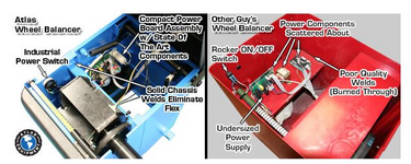

Well took a little longer to get but it arrived in good condition, no visible damage to crates. No time to assemble, it's snowmobile season, hopefully next week. I'll do an assembly review and mount some tires.
If you ever have a chance to pop the cover off, let is know if the internals look like those on the left or right.
Brand X
Sep 15, 2014
241
Looking inside a Atlas on the tire machine was not that impressive.. Lot of that is markeing on how they work..
Most are totally fine, and do a good job.. I have a Atlas midrise lift , but just could not pull the trigger on the tire mahine
for the price wanted..
