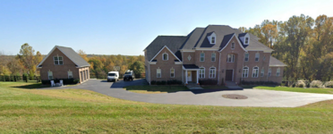

Here are some pictures of how I ran a 2" conduit for a sub-panel in a detached garage. Footing, poured 8" concrete stem wall, and 2x6 framing. The white painted rebar next to the conduit is the UFER.
Unfortunately, I do not have any of the framing pictures. I had the electrician tell me where he wanted the 16" o/c stud bay to be such that the conduit stayed vertical and aligned with his knock out of choice on the panel. The panel is ~14.5" wide and fit within a 16" o/c stud bay The stud bay wound up being an oddball (staggered) relative to the rest of the bays which were based on the overall structure and breaking properly with the sheathing.
The panel placement was somewhat critical as it had to miss a bearing point at the corner while also missing a window. The detached garage is 4 sides brick and I did not want any exterior blight on the structure.
Underground service via a 2" conduit was run along with a low voltage conduit for landscape lighting.

Looks great but wow the panoramic distortion in the photo is wild. Or your buildings are so large I can see the curvature of the Earth.

The photo is a screen shot from Google Earth street view.
That house is over 11,000 SF finished. 10' first floor, 9' second floor, and 8' finished attic. The detached garage is 24x30 with 10' first floor ceiling.
