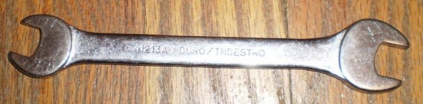

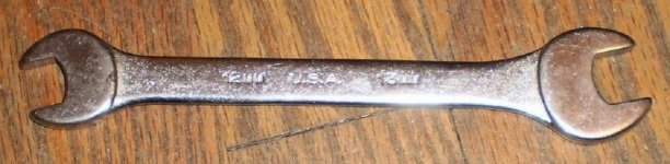

They say a picture says a thousand words:
I've always considered this set an example of their craftsmanship at its finest:
Indestro Select 919 921 922 923 924 15 offset medium double end box wrench 01.jpg Indestro Select 919 921 922 923 924 15 offset medium double end box wrench 03.jpg
And this set, most of which I purchased in 1971, to be exemplary:
In their waning days, this is the kind of product they were cranking out:
Duro Indestro 41213A 12mm x 13mm open end wrench 01 (Ebay 252532614808).jpg Duro Indestro 41213A 12mm x 13mm open end wrench 02 (Ebay 252532614808).jpg
