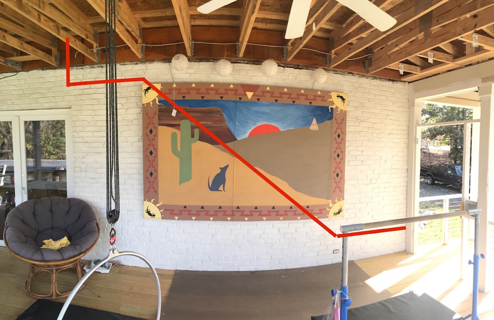

I looked at options for bringing power onto the porch in a way that wasn't ****-ugly:
1) Subpanel. Can't be in the ceiling, could be high and in a corner. Power from the bottom coming up a conduit in the corner between a pos and the wall. Paint it white. This would really simplify other wiring.
2) Remote subpanel. In the same spot, I could just have a 2" conduit from the enclosed crawl space under the porch. Yeah, I can't put the subpanel there so I would be pulling from the basement at which point I might as well come from my existing sub. That makes for some long-ish runs and crowded panels.
So it looks like I'm on the hunt for the shallowest and least ugly 8~10 slot subpanel available. Tentative plan would be to feed it with a 50A breaker and 6-3 from the bottom through the smallest conduit practical, and have a larger section of conduit going out the top to carry cables for three 3kW heaters and the porch lights and fans. What do you think?

The living room and the stairs, two step landing at the top and bottom. Solid 1930 brick; no stud bays. Looks like this. Below the line is the stairs down, above the line is the stairs up. 9' ceilings with the 2nd floor joists sitting on top of the brick. You can see a run of MC coming out at the top; it goes from the ceiling of the basement stairs up through the wall into what is probably floor joist space and then turns out through the header. I could probably pull a heavier cable (or additional cables) through there if I removed the baseboard in the upper landing, which would give me power from above albeit with a longer run. The basement subpanel is about five feet behind the lower landing, so it would be simple and short (but a bit ugly) to do the exposed subpanel plan from the bottom.
EDIT: at the other end of the porch it's just interior space. I could do the panel there, maybe even a bit easier since the main panel is right underneath, but the inside corner of the porch is less protected from the weather. The end in the pics has a roof extension over the exit stairs which shelters that whole section of wall, but the other end doesn't.

At this point I am leaning toward pulling three cables from the main panel below the other end of the porch. I have five empty slots in the main panel and as long as I can combine two of the circuits (bathroom fan and bathroom receps, any reason they need to be separate?) I can get six slots for three 240V breakers. It's a 30 slot QO panel; I could probably replace it with a larger one if needed.
I will post a pic but it looks pretty much like the mirror image of the doorway on the pics I posted, with a 6x6 up against the brick wall. I would either run a conduit in that corner or build a chase and pull some NM-b or MC through it from below.

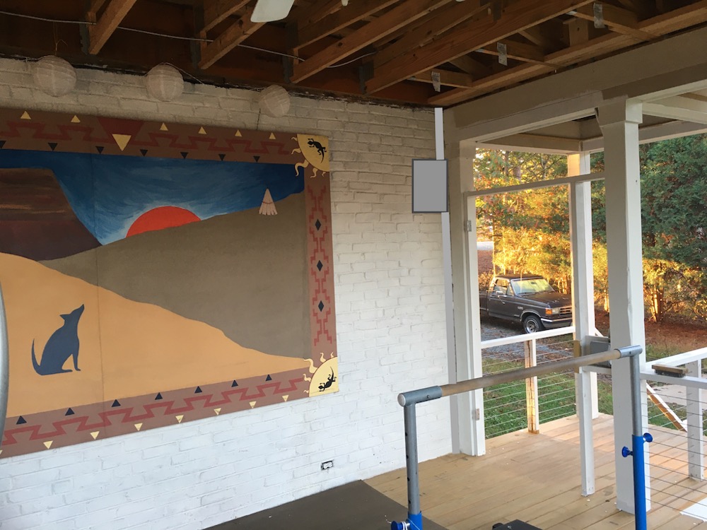

So this is pretty much finished. Three heaters are installed, looking like this:
I stacked three 4x4 boxes together for the controls, connecting them as shown to give them the needed 4.5" spacing.
The controls went into a corner along a post. It will be boxed in and painted to blend into the post after I buy a few more staples. :)
There are a few issues, though. One is that the triac controls make the 120V LED lights in the kitchen range hood flicker. It doesn't happen when the heaters are on full, but when I turn them down and the waveform gets chopped up the lights flicker. Think this could be resolved with some sort of noise filter in the hood? It originally had halogen lights but I switched them to LEDs several years ago.
Second, I need to upsize the breakers. The heaters draw 12.5A so the 15A breakers that I had don't quite make 125%. And last night, after a while they did trip, although the heaters weren't even at full blast so it doesn't fully make sense to me why they tripped. But they did, and they should be 20s, so I will go with 20s.

Maybe I missed it but is this an open porch or enclosed?
None of those 4sq boxes or MC cable are allowed to be outside.
