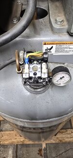

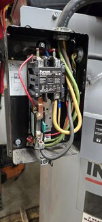

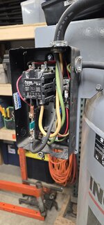

Wires from that black box go to the pressure switch. He took the supply power cable to the black box. I can't diagnose the motor until I have a supply power cable.

The *********/white/green cord going through the top of the enclosure should go to the motor.
The smaller cord out the side should go to the pressure switch.
The hole in the bottom is where the power used to come in, and the two hot leads (whatever color they are) will be landed at the two large terminals at the top, plus a green ground to the ground screw on the back wall.

The more I look in the black box on the compressor, the more I wonder how this guy had this wired. Only 1 lug has been touched to hook this up. I can tell by the screw driver marks. One of the lugs is brand new, hasn't been touched. So bizarre.

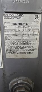

This is the label on the side. It says 1500 rpm for the pump. Would I be a able to use a 5 hp motor with the same pulley as long as the motor is spinning at the same speed as the 7.5? I don't see it would make any difference other than maybe the motor working a little harder than the 7.5? I won't be using this compressor non stop for weeks on end. I basically have a hobby shop and am only in here max 5 time a week, for a few hours each time.
American Locomotive
Jan 8, 2017
11,016
Rhode Island
This is where I loaded what the compressor is doing when I try to turn it on. And damn does draw some power. Makes the lights in the shop and the house flicker. Any insight would help. I am guessing the guy was right and the motor is cooked?
https://www.reddit.com/r/AirCompression/s/wqQf9cWmBf
It sounds like it just has a bad start capacitor or start switch. It's probably an easy, cheap fix.
If there were no difference, the compressor would have come with a 5HP motor, not a 7.5. A 7.5HP motor is 50% more powerful than a 5HP - that's quite a bit more "than a little harder".
