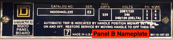

The 3 story house was originally renovated 30 years ago to be commercial offices. There are four electrical panels: A,B, C, and D.
There is 3 phase power: Panel A (225 amps)(various receptacles and recessed lighting) is almost full but may have a couple of spares. Panel B (225 amps) is all 3-phase for hot water and chilled water pumps, an (obsolete R22) air cooled AC chiller and some heat pumps. Panel D is relays and a time clock for outdoor lighting. So I think I have to use Panel C (100 amps) which has some outdoor lighting but has the most available room.
All panels are Square D Type NQOD (see photos of panel nameplates for details)
total hodge podge on the panels.... could be either 120/240D or 208Y/120.... if 120/240D you need to make sure you dont connect to the stinger leg (usually B phase) otherwise you can burn up the controls in your dryer since the stinger leg is 208v to neutral..... if the latter, then your dryer's heating coil will never operate at max temp....
can you check the main service to see what voltage you have?

Panel B is "Open Delta 120-240 with a 210 volt high leg service." (This is the "stinger leg" one of you warned me about.) I called the power company and asked and that's what they said we have.
There is plenty of room on the left and I just have to be sure to plug the new breaker in to connect to Black and Red (tape) input and not to the orange (tape) supply which is 208 to ground and will fry the dryer controls.
Panel C is a sub-panel of Panel B and has plenty of empty space and is only connected to Black and Red (so no wild leg).
