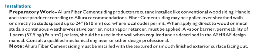

Is that texture 1-11?
That's normally attached to the suds .... If it is T1-11 ... it's the same as sheathing.
What you need to do is figure out any VB issues and follow the directions for installing as if on any new project. It's recommended to make a rain screen .... so it dries. You don't want trapped moisture.
Are you making a B&B look?

Looking at the spec sheet it doesn't say if the texture is T1-11. It does say that it is installed like conventional wood siding, and that it could be applied over sheathed walls. Would the existing wood paneling that is on the garage be considered sheathing if I go over it with the fiber cement panels? Or do I need to remove the old paneling and apply a vapor barrier and than attach the fiber cement panels to the studs?
I wasn't considering a board and batten look. Is there an advantage to doing board and batten?

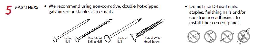

I have one more question about the fastener.
The installation instructions say there should be a minimum of 1-1/4” of penetration into the studs. I’m going over the old siding. The old siding and sheathing around probably about 1-1/2” thick. The new fiber cement siding is 5/16” thick. That’s about 1-13/16” of thickness that the nail has to travel through before it reaches the stud. I have a couple of questions about this.
1. The instructions say 1-1/4” of penetration into the stud. Since I’m going over the old siding and sheathing would that old siding and sheathing be considered part of the structure / framing? In other words, would the nail penetration into the old siding and sheathing be just as good as penetration into the studs? Or do I have to get at least 1-1/4 nail penetration into the studs?
2. If I have to get at least 1-1/4” nail penetration into the stud than I basically need a 3 inch long nail. I don’t see any 3 inch long roofing nails (pneumatic). The longest pneumatic roofing nails I can find are 1-3/4” if I have to get the 1-1/4” stud penetration what are some other 3 inch long nails I can use? I would assume the head of the nail needs to sit proud of the surface. If it countersinks it won’t do a good job of holding the 5/16” thick fiber cement siding.

Not sure as to the objections to hand nailing,I’ve been installing this stuff for twenty years and use both methods,it’s not even a little bit difficult to hand nail.Hand nailing also lets you know your hitting the studs for certain.

I appreciate the advice on the power shear.
Any recommendations on nails? Again looking for something that's about 3 inches long. It needs to go through the old siding which is about 1.5" thick to reach the studs. I assuming the head has to be a specific style to hold the 5/16 inch thick fiber cement siding in place.
