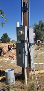

My shop currently has a messy 200 amp service, I'm in the process of replacing it. I also have a second 200 amp service that is live but not connect to anything( meter, disconnect, pole). If I ran wire for a second panel into the shop should the two panels be close to each other? I'd like to upgrade my three phase shop setup to 480v through a transformer. I currently have a 10hp rotary converter.

You are only allowed ONE feed to a building (with a few small exceptions).

You can have more than one panel. But they have to come from the same service and the disconnects must be grouped.

Only 1 service to a building with limited exceptions, as already mentioned. Going to 480V is going to get expensive to do right.

A 200A service should run a 10hp converter plus the rest of the shop just fine. Unless you have some other major loads your not telling us about.
I feel like you may have posted pictures in another thread but maybe you could post them again here along with your loads.

Yes, the current rpc will operate all the three phase machines I have. I plan to connect larger air compressor (15-20 hp) in the future. I'm sure the 200 amp will be fine, I pay a service fee on the other meter, better to have it and not need it........

NO youre thinking of the wrong thing. think of a multi-lug meter pan (not a meter main with a disconnect) with several disconnects coming off of it for feeds to several subpanels. The disconnects all need to be grouped in the same place.

Could have two service disconnects off the same meter. They would need to be grouped.
Common example is a 400A service feeding two 200A main panels.

If it powers nothing just have it shut off. Can always reconnect later. Why pay a monthly service charge?
Unless it doesn't meet current rules. Then the Poco won't hook it up until you correct it. They can't make you do anything if you keep the service active.
