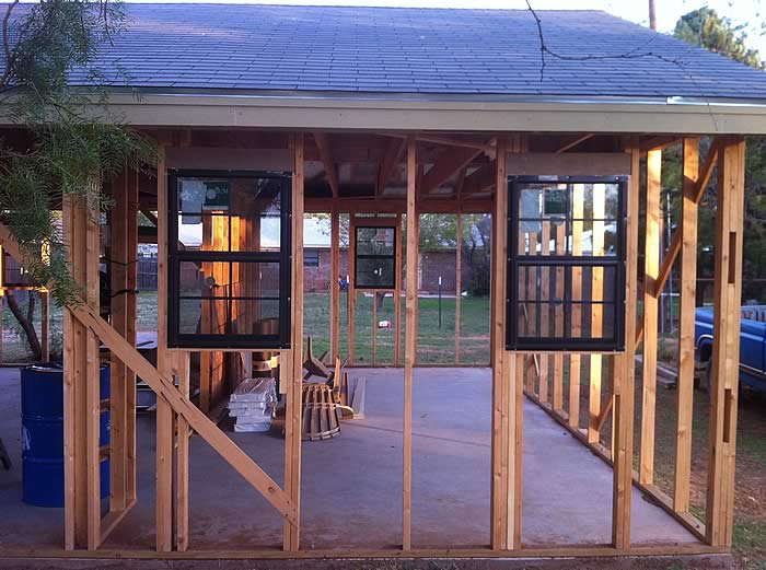

Mine are nailed to the studs - regular aluminum windows from McCoys. Just be sure and flash them good. I used 15 lb tar paper in layers.
