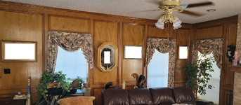

existing wood trim on stairs will be cleaned and polished. looks bad because it is 40 yrs old.
risers appear to be particle board. will find out more when we rip the carpet off.
living room custom woodwork shown for reference. going to be stripping popcorn ceiling and re-finishing the hardwood floors.
