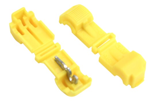

These are the taps you can use for #12 feeding through strip fixtures with a #18 ballast lead:
http://www.newark.com/jsp/search/productdetail.jsp?SKU=90F6225&CMP=AFC-GB100000001
So does this allow you to make your "feeder lines" continuous? Do you happen to have a picture in application?
I am about to do the same thing, never seen these connectors. I just used wire nuts in my current shop...
Do these lights bolt end to end or how have people been connecting them to each other?
Yes. And no I don't, sorry.
If you notice one side is larger than the other, so the #12 can remain continuous through the lights and the #18 ballast lead can be tapped off.
I have to say, I only use these when there are a LOT of fixtures (like 50 to 100, or more) and time is of the essence. They are definitely more expensive than wire nuts, but are a great time saver.
Thanks, I will probably just go with wire nuts, I only have 12 to install...
