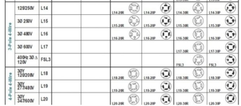

I am not in a rush but this showed up locally. It is a Delta Unisaw 34-806F
It looks to be a single phase from the pic of the plug. I may be able to go look at it on Monday but would like to learn a bit about these saws before going up there.

Unifence is, in my opinion, far better than Biesemeyr. All parts are expensive. That appears to be three phase. The motor configuration is unique to Unisaws and very high priced. So much so that I ran a three phase on an inverter to save needing to buy a motor. Prices for complete saw generally start around $600 and can go way up.

looks like a decent saw. the plug , being in a school setting is probably 3 phase. yes, motors are pricey for unisaws .

As far as the plug in the OP's post. It looks like it has 4 prongs, that makes it a 3 phase machine. If the price is right buy a VFD and wire that in, but it will add $300-$400 to the price of getting it running if you only have single phase.

By the part number its a 5hp 3 phase machine, but, mine was to, but someone coverted it over to a 3hp single phase motor. 4 prong doesn't make it 3 phase. Who knows what some nutball wired it up with. Look at the motor name plate. I would agree with the VFD. I wish mine was 3 phase as I hate the thump of belts when it starts. A VFD can give you ramp up and down, also safer bringing the blade to a stop faster

It is 3-phase so a little VFD homework is in order.
