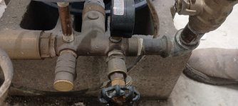

The short piece to the right of the drain valve, under the pressure switch ****** - is that a pressure relief valve?
It doesn't look like any that are currently sold.
If not, is it a cleanout? Looks like pvc.

No... well aside from it'll probably blow before copper pipes do being it's plastic.
Just redid mine, was a mess. Temp job, but still.
The pressure switch was not working right and the pressure approached 100psi before I shut it off.
The plastic plug did not blow out. I need to replace it with a 75psi prv.
The pressure switches are often mounted on a 1/4" NPT long ******. Those get plugged with crud.
Always clean/replace the ****** when you are having pressure switch issues. You appear to replaced the ****** and the switch already.
I have our pressure switch adjusted for 50 psi cut in and 70 psi cutoff. My PRV does not weep (not sure its setting now that I think about it).

It looks like a cold start valve/ they are used in hard to start air compressors and let pressure bypass till something like 10 psi to relieve load on the compressor until everything gets spinning at full rpm. yours looks like a water system?
I've never seen a pressure reducing valve on a well pump...
Adjust (or replace) your cutoff switch and verify tank bladder is all you need

That is a Cycle Stop valve. Also known as a mechanical constant pressure valve. I have used many. It makes you able to use a much smaller tank than normal, and still get enough pump run time, plus constant pressure.
Really?
Looks a hell of a lot like the standard brass fitting that you get for any standard pressure tank...

I replaced the pvc plug with a 75psi pressure relief valve, and I replaced the drain valve which was dripping.
Make sure your switch is shutting the pump around 60psi.
100 psi relief valves are also common.
