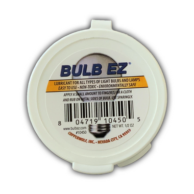

If you can find heads like that for L style you'll be good to go. It's 120 volt track. You might already know this but if you plan on attempting to change bulbs with a pole, be sure to lube the threads at the base of the lamp or the suction cup on the end of the pole might just spin when trying to unscrew the bulb; there are a few products that are all the same, Bulb-EZ is one brand:
I've also used De-Ox in the past:
