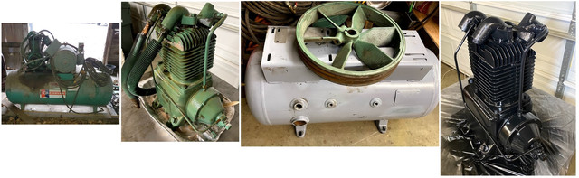

Receiver: Started with a Gardner Denver 30bvacc10 for 250.. stripped it down & sold the little pump & 3 phase 1hp Baldor motor each for 50 bucks..
Pump: Had to spend a morning driving to a little town the next state over, but snagged a old 80 Gallon Champion with an R15A & a 7.5 horse 3 phase motor for 300 bucks (the guy also threw in a neat old vise with no markings on it). Sold the Motor with its magnetic starter for 100 & the rusty old receiver for 50.

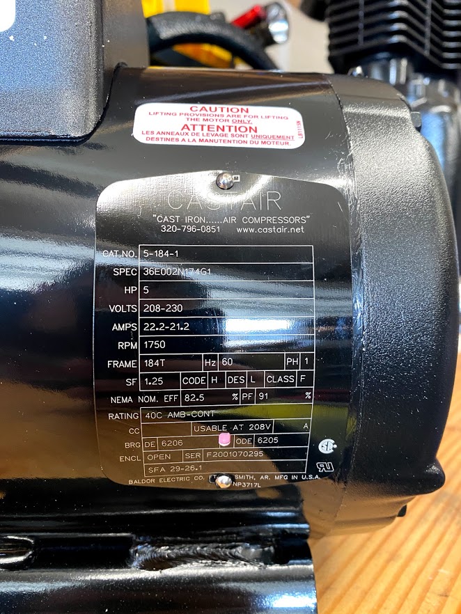

Motor: Could not find a suitable used motor for a reasonable price.. So I snagged one of the Castair (Baldor L1410t) from UPE_Group on ebay for 400 bucks along with a 6.75" pulley for another 47.

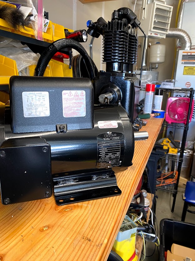

Motor was delivered.. Poor FedEx guy couldnt of weighed much more then the motor & did a awkward little waddle carrying it up to the front door & doing everything he could to put it down nicely.

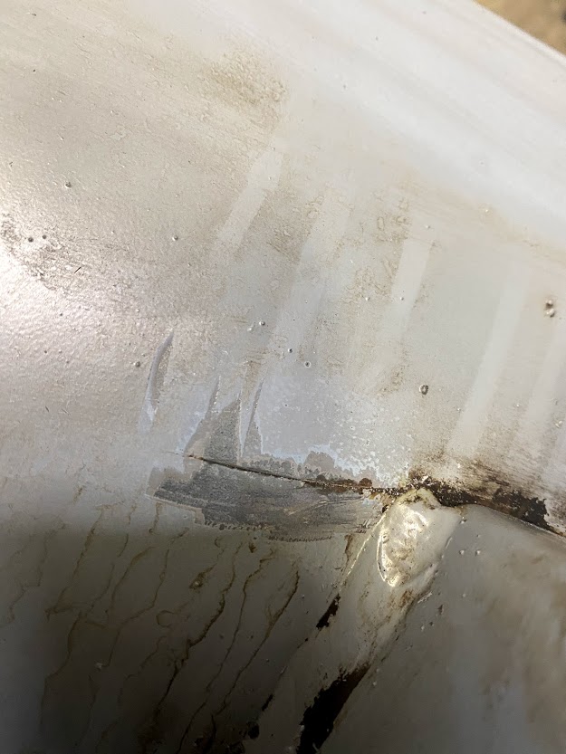

Flipped the receiver over while removing one of the inspection port fittings (one came out fine, but one at the far end of the receiver was put in all the way to to the flange) & found this.. So its going to be a smoker instead of an air compressor. Thats 150 that I am not going to get back. This wasnt rusted through, it was some sort of an impact it seems.
Now I have to order a new receiver. Thinking I am going to order this. But really dont want to spend 500 bucks on it. After spending months trying to find the last 30 gallon receiver though I am not patient enough to do it again & I sold my old 60 gallon so I am without all together right now.
Edit: Found a better way for the receiver. I got a local place who never seems to be open when I call that finally just answered & they carry them, also have one in stock for 415. So I will swing by after work tomorrow & grab a brand new receiver. It is the same Manchester I linked above.

Well the search for a receiver continues. I went down tyesterday.
Couldn't that crack be welded? I mean by a Professional Certified Weldor competent for pressure vessel welding? Seems it should cost less than a whole new tank...
Maybe.. But it would of still been a used tank & I would of had to track down someone certified & I couldn't find anyplace local that works with pressure vessels that looked to be doing small stuff (one place, but they were like 1500 gallons & up only). Plus now there is no question of the amount of rust in the tank being zero. This will end up with an auto drain eventually & I am half tempted to attempt to coat the inside of the tank before I mount it all together in an attempt to keep it rust free for decades.
