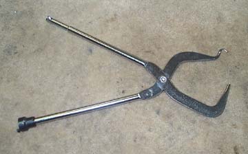

When you twist the handle, only the 1/4 drive moves. Anybody seen or know what it would be called?

Look's like it might be a tool for adjusting idle air screws on carburetors.

I've seen them used to adjust carburetors, not sure of the name though.

Definitely a carb tool and also gm distributor tool. Likely came with a screwdriver socket or 2, allen socket and a few others

snap on sells another version that is flexible, its awesome!! put sockets on it and run something out once broken loose, or use it to start a fastener that you cant get your hands on. Well worth the 25 bucks.

It's for adjusting carbs. I have a kit that I bought off the SO truck probably 8 years ago. I'll add a picture when I get home.

You use it for adjusting carburetors and GM points, kit should include 3 different flat screw driver type sockets and a ball end allan wrench socket. I also bought a double D socket for later Quadrajets.
It's a Snap On/Blue Point tool, Snap On also made one with a flew where the bend is.

I made one not too long ago, as my 80's truck has a carb, and so few shops will actually work on carbed vehicles.

Is it right handed or left handed ? Makes a difference on which Carb you use it on!

^ this. some were made with a short section of flexible shaft at the drive end - we sold them in Indestro - full kit was a #2820 - attachments were available separately.
mostly for GM Quadrajets and 1957-1974 GM V8 distributors, as I recall.

I knew you guys would know. I had a exciter wire on a starter just being a PITA and guy had this worked awesome. He didn't know what it was either but I bought it at the price he paid at yard sale couple weeks ago lol.
