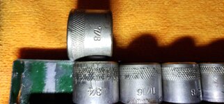

Here is another small box
Decal on the box say "WAKEFIELD SOCKETS, ALL STEEL, SET No 4, WORCESTER MASS U.S.A"
The ratchet is stamped "WAKEFIELD No 14, MADE IN U.S.A"
"ELL" is stamped "WAKEFIELD MADE IN WORCESTER MASS"
The drive adapter is marked only with "MADE IN U.S.A", while the eight sockets are stamped only with the sizes.
IMG_20220829_172815.jpgIMG_20220829_171819a.jpgIMG_20220829_172202a.jpgIMG_20220829_172325a.jpg

Nice acquisition! Love the decal. That's from their late production period, after 1925, after the son changed the name of the company from Wakefield Wrench Co. to Wakefield All-Steel Wrench Co.
Assuming you bought that on-line and didn't actually find it in Norway, right?
As an indication of how rare it is, it's only the second socket set we've seen here on this thread after Beatle's big set with the break-down speeder inside (post #68, page 2), there are no Wakefield All-Steel socket sets on AA, and it's probably one of the last four patents (between 1928 and 1931) that 4.c posted in the post just above yours, which are all in the 'not known to have been produced' category on DATAMP.

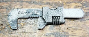

Picked up a new Wakefield bicycle wrench for the collection. Not a dupe. Similar but first like this I have had with the PAT PEND marking. I guess it's a pre-"Wizard" pre-"No. 7"? I'll have to do some thinking on that.

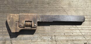

What do you guys think about this one? Says it’s a “Wakefield Cycle Wrench”. Thinking the solid, non-riveted dynamic jaw may indicate earlier production? No luck locating a utility patent that matches - maybe it’s a design patent, or was not granted IMG_0742.jpegIMG_0741.jpeg
F
29,623
^ I believe I have a copy like that but all my photos are in my computer - nothing in this laptop.
Wakefield made various models of "bicycle wrench".
This is all speculation, but I think by the time founder and father John E. passed, son Clarence already had his fingers in several other pies and dove into that "diversification" thing with both feet - resulting in different company names and a broader variety of product offerings.
It would really be nice to have something in the way of "catalog" but so far all we have are little snips from hardware catalogs.
Wakefield cycle wrench

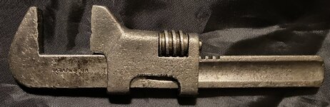

Added this bicycle wrench, found at the flea this morning, to the Wakefield collection, which raises my total to thirteen (13) tools now, no dupes. No model number, no other markings. Black baked enamel finish is all but worn off.
