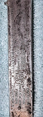

I cannot see the second digit because of the rust-eroded surface, so this is a hypothesis. The wrench in question is not a “No.11,” but a “No.19.” It is diffent from the previously-posted No19 because it is a different age, contemporary to the No9. IMG_4767.jpegIMG_4767.jpeg
I don’t have the font I need to show my thought more clearly (in red), but I think you can see the 9 on the No9 fits right into what appears to me to be the bottom curve of a 9 in 19 of a “No19.”
AntiqueBen
Aug 4, 2021
1,442
I have contemplated & looked very closely at this too. The second digit is not a 9. When I get home this evening I'll post better pics of this area on the wrench. At first I thought what you're thinking, which would have explained the problem, but this isn't the case.
AntiqueBen
Aug 4, 2021
1,442
@AntiqueBen - any idea of the DATES of those ads you posted (post #137) ??
I would have to go back & look. The earliest was 1904 & the latest was the late 20's. I was mainly looking for information from about 1920 forward since the patent date is 1922. I found several other Wakefield ads that I didn't save due to them being earlier than 1922.
LesserSon
Feb 7, 2016
5,106
PA USA
I hope a pic can resolve it, but that surface is rough. In the meantime, I can’t see ruling out a “9” there.
I see the mostly straight, broken vertical line I presume you’re identifying as a “1”
but then just to the right is a “J” that to me suggests remnants of a “9”
There are Wakefield No.19 wrenches on eBay, both for sale and sold. There are no Wakefield or Wizard No.11 wrenches. If it is an 11, then it is unique, not just on the GJ thread.
There can't be a 9 there like on your last pic because your using the stamped parentheses as part of the 9. I realized another big difference. All no. 19 wrenches are stamped Wakefield. Mine is stamped simply Wizard. All the others I can find marked with the Wizard name is actually stamped Wizard Wrenches. The fact it's simply marked Wizard would imply that it's not a no. 19 since all other no 19's I've seen is marked Wakefield. Without hard evidence it's difficult to say for certain. Below are some clear pics of how the no. 19's are marked. Mine is clearly much different. It will be fun to try & figure this one out.
So, you think “No.11)” is what you’re seeing? Why would there be a single parenthesis? They usually come in pairs, except for ordered lists.
I still think the most obvious interpretation is “No.19”

The one thing that gives me pause about this explanation is the OAL. @AntiqueBen reported it as 10-1/2". My No. 19 is 9", exactly as advertised, and exactly the same as my No. 9. And it does fit the nominal 2-inch OAL steps.
Well, hell, I don’t know how I missed that. I’ll have to re-read those posts: I thought the controversy was that it WAS 9”!
All of the Wakefield's with the 1922 patent only has one parentheses. I have no idea why Wakefield chose to do it that way. Look at Lugz's wrenches in post #131. They are all like that just like all the pics I've seen online.

It measures just over 10-1/2" OAL.
Uh, yeah, there it is.
Somewhere later I got confused that it was 9”.
EDIT - I was trying to read GJ while MrsLS was dodging emergency vehicles and other calamities on the way to Mystic.
AntiqueBen
Aug 4, 2021
1,442
You are mistaken, Ben. Look at the photos of my No. 7 and No. 9 again.
Different wrenches all made prior to 1922, when the wrenches we are discussing were patented and made. When I said that my No. 7 was 7" long, did you not believe me? Trust me when I say that trying to build a consistent timeline of Wakefield adjustables is a fool's errand! They even re-used numbers.
Boy, I missed that one too. Well Lugz, I have to say, your no. 7 & 9 marked Wizard are the only others I've seen marked Wizard other than mine. Every other no. 7 or 9 I've seen was marked Wakefield.
30,911
They were not conservative about using it. Of my sixteen (16) pieces, almost half of them are post-TM. The bicycle wrenches to the left bottom are a No. 5, No. 6, and No. 8, by the way, all 1900 patent, all pre-TM. And they are 4-1/4", 4-3/4", and 6" OAL, respectively. It was a whole 'nother scheme. That wrench on the lower right is a B-1. And if you look at the No. 19 and No. 9 on the right, you can see that while they are both 9" OAL, the housing on the No. 19 is wider.
