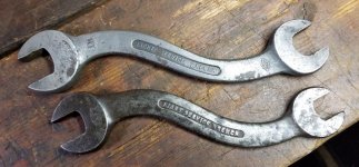

I also have these very literal, unmistakable "Light Service" Wrenches (also called Carriage Maker's wrenches in the catalog), Brooklyn plant logo, but they are very early, tool old for your board, bearing older 3-digit versions of the Light Service wrench model number scheme, and not the right sizes. You need a 79S and an 81A and these are 679 (they made a 679A, but not a 679S) and a 681 (they did make a 681A). The 681 has the model number forged on the shank near the logo face, the 679 has the model stamped in the face opposite the logo face.
I'll stand pat just using the body numbers from the hardware book page above and my list. thank u.

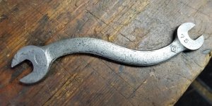

For williams experts, what is the wrench shown at the very bottom? Its not listed in the list of wrenches displayed on the 90" board. That wrench is hanging on bolts/studs used at the only thru holes in the board. I guess those holes are for fastening the bottom of board to the base board. THAT wrench is shown on the 4 illustrations i've found from 1915 to 1928.
I am seeing a box end (on the left) and an open end (on the right) in that illustration Todd just re-posted. Nobody was making what are known as combination wrenches today, but the were making special wrenches, including Williams. I wouldn't bet my next paycheck on this, but I am thinking it might either be a 990 Draper Loom wrench (see page 24, 1912 cat) or a 993 Spark Plug Wrench (see page 58, 1912 cat). Both are very similar, with one 6-point box end on one end, which is offset, and an open end.

Then again, the openings might be too small for either of those. Look for another special combo type wrench. I swear I am seeing an offset box end on the left.
I agree, but kinda leaning towards what might be a very popular wrench back then, the spark plug wrench especially if its for a model t. It might not be the 1 illustrated but in demand then. Might be easier to find too.

I have an 81A in decent shape.Doesn't say "Light Service" though.
DSCF2249 by wvwheaties, on Flickr
DSCF2250 by wvwheaties, on Flickr
30,727
I don't think it's supposed to. Those are the very early models with a 3-digit model number, 6XX series. They dropped the "6" prefix later, and those 2-digit model numbers a(just the ** part of the older numbers) are the wrenches on Wrenchguy's board. Sorry for causing confusion with me showing those. If you scroll up, he has a 75B from me just like your 81A.
