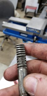

I have a 14N 3JT super chuck that a jaw is missing 3 teeth on. Weird part is nothing else in the chuck is hurt.
So the chuck body states the service kit 30345 for it which is basically everything new but the body and sleeve. Way more than I need a new set of jaws would put me back in action. So service kit is around $165 plus shipping is the best I have found or I can but a new chuck for $185... WTF
Anyone know anyplace that is reasonable for jacobs parts or sells the jaw sets with out the rest of the guts?

I've rebuilt a lot of chucks. Sadly rebuild parts are very expensive, too much to justify. It also doesn't guarantee good & straight performer afterwards. Those broken teeth is a concern, can you see any marring or scratches or grooves in other parts of the chuck?
Suggest buying another one on ebay. Only look for a USA made ones. Jacobs made in USA are the only ones labeled with USA on it, The rest are China as Jacobs since moved all their manufacturing overseas so make sure its says/see USA on the chuck itself in the pic otherwise pass.

Macgee,
I need to clean up everything real well and inspect, nothing obvious jumped out at me at disassembly.

Yes, please clean up, soak all the parts in a strong degreaser and then wipe clean. you then be able to feel all the surfaces for unevenness.
Again, best solution is to replace. When looking on ebay, be selective and make sure they have a pic of the jaws closed to see wear and how jaws line up together and a pic of the MT taper to see condition. Drill chucks are all about having good runout. It's a real shame Jacobs and Albrecht charge so much for their rebuild kits making you buy new chucks.
I may have a couple of 14N's laying around that I could sell.

I looked all the parts over again and everything looks really good inside this chuck except the obvious issue.
