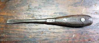

An old story that I am sure most of are GJ readers are aware of but I thought for a few of the newer members might also enjoy this story.
I was very lucky in that I stopped by a small garage sale last week and there under a pile of old rags was this old vintage RYAN screwdriver in very good condition for its age; my lucky day kind of like hitting the lottery as they say.
James J. Ryan was born on the 3rd of Oct. 1872 in Southington, Hartford County, Connecticut and he died on the 26th of June 1974 at the ripe old age of 101 years. He is buried at the Saint Thomas Cemetery in Southington, Hartford County.
He started out as the James J. Ryan Tool Works and later the J.J. Ryan Tool Co.; and later it became the J.J. Ryan Corp. They are the Parent Company to the Rex Forge company still in active business today.
This story has a very rich History and if you have the time please be sure and read all the links, included you will find not only his life history along with a catalog from the 1940's, a grave site marker,and the rex forge company information.
On a very interesting side note (something I forgot about) they took over making the perfect handle screwdriver from the H. D. Smith company,back in the 1930's.

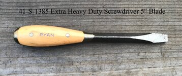

Found a decent "perfect handle" pattern screwdriver at the flea market yesterday with a hex shank for turning with a wrench. I've found vintage H.D. Smith, Tobrin, Irwin, Federal, and now Ryan in this style. This is my first Ryan tool of any kind.
Pic 3 is a page for this screwdriver in the Ryan catalog Woody linked above. They called it the "original Wrench Grip Perfect Handle Screwdriver." That's a twist, pun intended, on the H.D. Smith name. So is the name "Perfect Grip" that they gave the more typical H.D. Smith "perfect handle" pattern type screwdriver on the very next page of the catalog. Just enough connotation to its predecessor.
The catalog does not appear to be dated. Has anyone tried to date it?

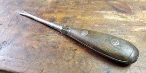

I am 100% positive that this 4" (blade length) DUNLAP "Perfect Model" screwdriver with the BK code was made by James J. Ryan. Happy to find it at the flea this morning.

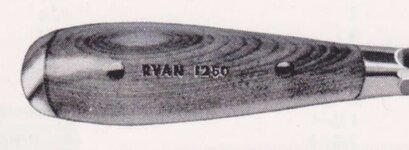

Wow, that's super clean, Don. I'm not quite sure how to date it, though. There are two Ryan catalogs on IA/ITCL, in case you haven't already seen them. Catalog No. 23, which is not dated, does not offer an Extra Heavy Duty Machinists' type "Perfect Handle" screwdriver. All the "PH" types have "RYAN TOOLS" stamped on the shank. (I have a couple Wrench Grip types posted upthread.) Catalog No. 26, which is dated 1958, does include an EHDM "PH" type, your NOS'er is a spittin' image example, and the illustration is clearly ink-stamped on the handle. As an added bonus, the page is advertising their compliance with Federal Spec. No. (GGG-S-121c), typical in the late 40's and 50's boom cats (e.g., Fairmount). Check it out. Pretty cool.
16,721
It will be difficult to date exactly with a lack of wartime catalogs but it has the unfinished shank and visible grind marks common to wartime extra HD screwdrivers of which I have more than a few in various brands. The postwar catalog’s example shows a part number stamped and the shank looks more nicely finished than mine. IMG_3248.jpegIMG_9709.pngIMG_3252.jpegIMG_9708.jpeg
