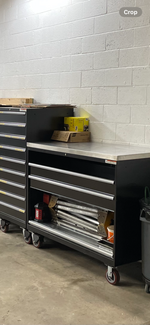

Admittedly I didn't document this well, mainly because it was brutal and I hated it.lol
I took 150mm of height out of this lista chassis to make it a DW750 from a DW900. I can now actually use the top. It was my first scratch and dent purchase from back when.
Lots of spot weld cutting, weld grinding and band file work. You can see unfinished plug welds ( I could have bondo'd everything ) and a slight mismatch in touch up paint on the sides and back, but I'm pleased for purpose. I was able to hit the measurements, drawer fit and leave the front untouched.
