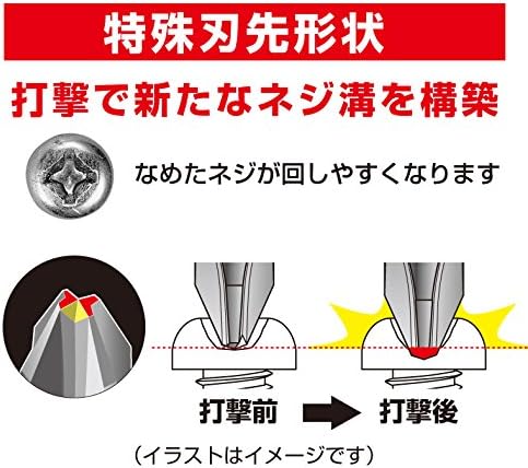

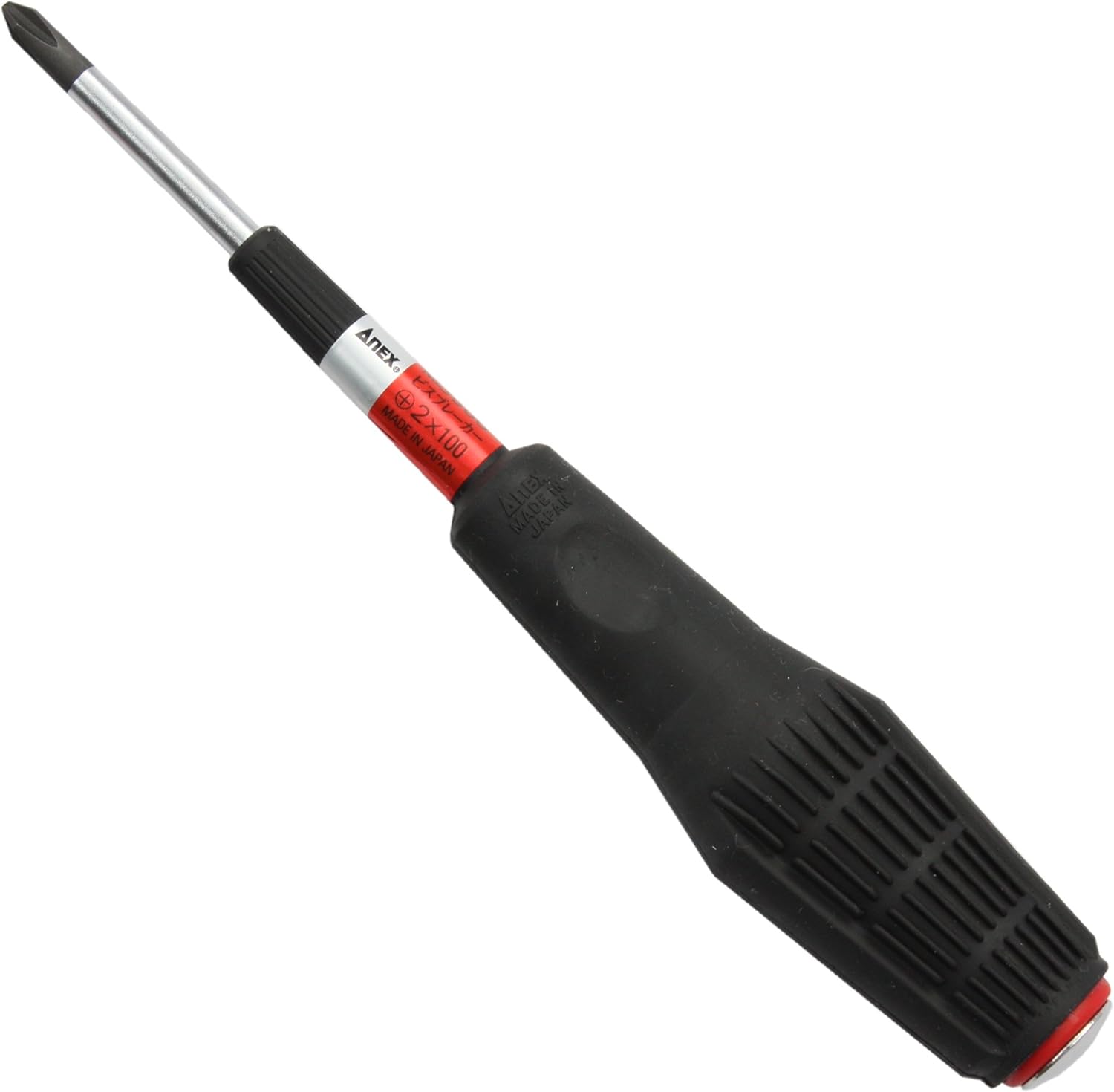

Anex is another made-in-Japan driver specialist. Their new driver is both a regular AND an impact driver in one...
Are you sure that Anex is an impact driver? It's not clear from any description that it turns a screw when struck, like a conventional impact driver and the Vessel Impactas (at 12°/strike).
The Anex looks like a special hardened tip that cuts new driving surfaces in crosshead or slotted screw heads. The idea seems to be that with a new head cut the screw can be turned conventionally.
Yup, sounds like you are right.
Translation from the description:
Hit with a hammer to make a groove
By hitting the washer with a hammer, a specially shaped cutting edge creates a new groove in the screw with a crushed cross hole.
You can also remove the tanned screw by rotating it while pressing it.
