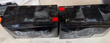

I need a replacement battery for my JNC AIR. The JNC105 replacement from Clore is $100 + $24 shipping. I was looking at the Mighty Max equivalent. The Mighty Max ML22-12 is $46.99 delivered and the ML22-12 GEL is $59.99 delivered, both from Amazon. Suggestions?

I have bought several replacement lead acid batteries for solar jump pacs over the years from the river and the bay sites. Although they were much cheaper than the clore replacement batteries they don’t seem to last. The cheaper batteries are lucky to get a year but as low as 25% the cost of a clore. Maybe I have just been unlucky in my purchases but that has been my experience being a cheapskate. Unfortunately a clore replacement battery is about the same price as a complete new booster pac with new leads, new charger etc….Spend the money on a quality battery replacement or a new battery pack IMHO, YMMV.

I have had good luck with the Mighty Max batteries in my Clore. I dont use the jump pack that often but charge it every six months. I get three to four years out of the Mighty Max batteries.

Mighty Max batteries are probably OK if your device has a smart charger. If not like a Tripp-Lite UPS, this is what will happen in 2 years.
I am unimpressed with Mighty Max. I bought a Mighty Max ML22-12 two years ago for my JNC660. When tested with a carbon pile it was substantially weaker than the original battery (B.B. Battery HRC22-12S). The Mighty Max died after 2 years. The original battery also died prematurely, after only two years, and only one use, despite being charged every 1-2 months.
The "high rate" BB Battery HR22-12 battery is $92 here:
OSI Batteries
My original battery is the JNC105, not the BB. I think I am going to replace it with the Mighty Max ML22-12 GEL which is a high rate battery like the BB.

I am surprised to see Mighty Max recommending a charge voltage of 14.5 - 14.9 for their gel battery. Usually it is advised to charge gel batteries at lower voltages than for AGM.
Do you know the max discharge current of the MM Gel battery? For the B.B. AGM it is 300A for 5 sec.
