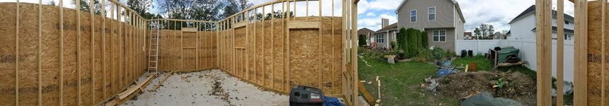

Been wanting a second garage building for years. Detached. Somewhere I can weld and paint and test fire engines without filling the house with fumes. Many years and a move later I'm getting it. Not quite what I envisioned all these years. Was hoping for at least 2 car, maybe 20x30 but had to settle for 16x22 due to easements and SWMBO. Got a late start to the project this year. Here are some pics of current progress.
Had to get the shed out of the way. Engine hoist on one side, bobcat on the other.
Bobcat wasn't strong enough to lift the whole shed so we put the frame of my '56 Chevy 3200 under it.
Dragged it with the bobcat, got it turned around, and placed on the opposite side of the yard.
The aftermath of moving the shed. Only found 1 rodent skeleton.
Clearing out the sod.
Trenching in progress for thickened edge slab.
Got some gravel down.
All formed up, rebar, remesh, vapor barrier. Forms are stepped front to back to maintain minimum 12" thickness and 6" depth. Thickened edge is 12" think on the front edge, 23" on the back with 2 steps between.
Concrete poured and hand finished. smooth as a baby's bum. My concrete guy did a hell of a job.
Putting the jeep, and driver, to work.

Worked all day until the thunder started. Got the 4th wall up, window rough openings done, squared up the building and got some of the top plate nailed down.

Finished the top plate, got all the walls final nailed to sill, added some corners for drywall and threw on 5 sheets of osb. It was slow going on my own. I think the most time consuming part was cleaning the attached garage well enough to get the osb out.

Got some more sheathing up today. Had some help this morning then hours of nailing nailing nailing. Nearly ran out a brand new box of 1000 in my air nailer. It kept misfiring so that added to the time trying to make sure it was shooting nails then going back over nearly half that it left proud.
