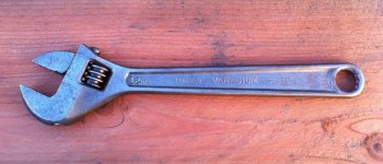

10 in betr grip merit made in
That's what one side says
10in forged vanadium steel 5/8 in
and it has a six stamped in by the jaws merit is stamped in everything else sticks up. Not a hex but not square either

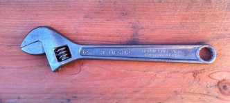

I am attempting to reinvigorate this thread, hoping it will become the repository of discussion of the JP Danielson company, tools, etc, during the time before it was absorbed into the Proto Empire.

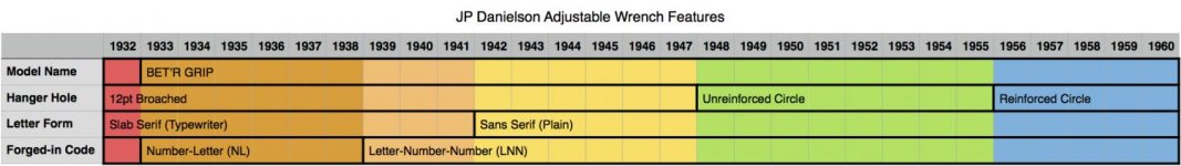

Here's my first contribution: a table showing six phases (by color) of the adjustable wrench, from the early 1930s to the early 1960s. The design changes (hard borders) of four features narrow the production date down to approximate decades. Once done, the three-digit date code, Letter-Number-Number (LNN) can be used to determine specific year of production. The rightmost number is the last digit of the year. The central number is believed to represent the month, because it apparently runs from 1 to 12. The letter probably represents the day of production. All known examples run from A to Y, so 25 characters. I have some ideas about this, which I will share in a separate post.
As you can see, sometimes using a single design feature - like the broached hole on these two wrenches - the single digit year can be understood; in the first case, 1940. However, you have to see that the letter form of the second one is sans serif (plain) to distinguish it as 1944, from 1934, which would have a slab serif (typewriter) letterform. The third one is...
That’s right, 1952, because the round hole has no reinforcement.
The fourth case shows the reinforced hole, so...1964.

So what is the difference between “Typewriter” (slab serif) and “Plain” (sans serif)? I actually don’t like those terms.
Manual typewriters used a letterform where each character occupied the same horizontal space. Typically they also had pronounced serifs - the little, terminal lines at right angles to the main strokes. Your computer probably has a “Courier” font that is similar. But I used two different manual typewriters where the characters did NOT have serifs. They were sans serif, like the familiar “Ariel” font. (Sorry to those who know that Ariel characters are NOT all one width.) To my mind, “typewriter” should only imply uniform width of characters, which is the situation with both of the two different styles of forged-in characters on JP Danielson wrenches. Letterforms with prominent, block-like serifs are termed slab serif. You may have “Rockwell” among your fonts. It’s a lot more like the Danielson slab serif than Courier (or any other typewriter font is. But “typewriter” is what people are already using.
I wish I had a larger example of a slab serif adjustable - this one is 4”, so the forged-in letters are a bit wonky. The sans serif letters on the 12” are much more distinct.

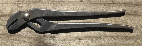

Pic 1: The adjustable crescent-type wrench is perhaps their most recognizable product, with the most followers, and for good reason, but here are some examples of other tools.

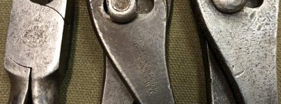

Pics 2 & 3: Date codes on the 1941 CONTROLLED STEEL waterpump pliers (not the best specimen I have ever owned, unfortunately) and a few CONTROLLED STEEL DOE wrenches. Note: The waterpump pliers are highly desirable with GMTK collectors due almost exclusively to them being date coded. I have found several of them over the years and put them in my own GMTK's and moved them on to others for their GMTK's.
Pics 4 & 5: Markings on the battery pliers and slip joints (oddly, Crescent-made).

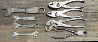

8in and 6in slip joints along with 6in side cutters.

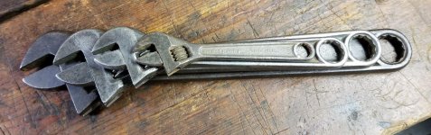

A handful of adjustables. two 12in Danielson and a 12in Penens, 4in Danielson and 8in Danielson.
Date codes on the adjuatables are as follows from top to bottom
12in Danielson (W-7-3)
4in Danielson (8.1.4)
12in Danielson (M-3.5)
8in Danielson (V-12-2)
12in Penens (S.3.5)

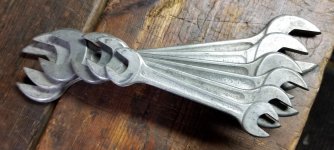

Ive got a set of Controlled Steel double open S wrenches.
Each one has a different code.
