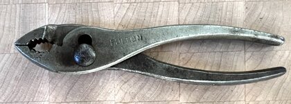

Sometimes Danielson would ship pliers with no handle embellishments at all. Doesn't look like there is a date stamp on this, at least that I can find. I’ve seen prettier Fulton’s. Anyone know when these were made?

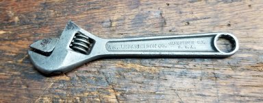

A few that are in the adjustable wrench drawer;

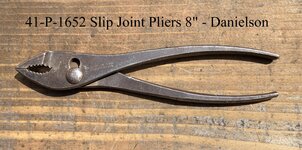

Here are some 8” pliers found at yesterday’s estate sale. I haven’t been able to find any date codes but sometimes they are hard to spot. They look GMTK correct to me.IMG_1787.jpegIMG_1788.jpeg

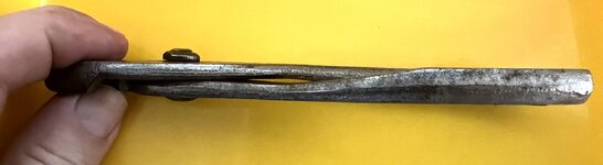

Most of the JPD information I find deals with the flat wrenches and pliers, not much on pipe wrenches. Found this one at a yard sale, marked “14”, very good condition except for the chipped end of the moving jaw. Any idea of its age? Paid $3.

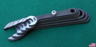

29,774
J.P. Danielson 6 pc Auto-Kit 100 Wrench Set
5/16" x 7/16" Auto Kit 100 "Vanadium Steel"
7/16" x 1/2" Auto Kit 100 "Vanadium Steel"
1/2" x 9/16" Auto Kit 100 "Vanadium Steel"
9/16" x 5/8" Auto Kit 100 "Vanadium Steel"
5/8" x 3/4" Auto Kit 100 "Vanadium Steel"
3/4" x 7/8" Auto Kit 100 "Vanadium Steel"
Tapered Screw and Round Knurled Nut

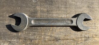

I got this spanner at a car boot sale on Sunday. It shows no signs of use. Date code is J.8.5. and I assume that it came to the UK in WW2.
I don't think that I have ever seen another Danielson Controlled Steel tool here in the UK.

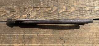

Plucked this 4-incher out of a box at the flea this morning. This is one tool I don't mind having several. Only the second wartime (1943), the others are prewar. I guess I'll stop when there's no more room on the Fleet rack hook for them. :)
