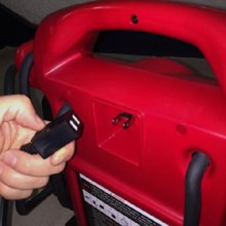

Can you plug the JNC770R into a wall outlet like the JNC660? Or does it have to be charged through the cigarette lighter plug or some other proprietary connection?
It does, on the back of the unit:
It comes with an "extension cord" (shown, both in this pic, and in FigureItOut's post above) that may or may not be required to plug in - can't tell if the ported area surrounding the plug would accomodate a normal extension cord or not. (Pulled that picture from an eBay listing, can't find similar shots on the Clore website.)
It will fit a normal extension cord. I have a locking plug on mine that's quite a bit bigger than a normal extension cord plug, and it fits fine.
