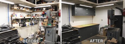

I have a small home machine shop, in which I both modify and repair things (mostly paintball guns :D ) and manufacture parts for same. It's not extensive, it's basically just a warmed-over two-bay garage, and for many years, it's been little more than an ad-hoc workshop for everything from welding to carpentry.
Over the last few years, I've been working hard to finally get all my waterfowl a bit more colinear, and have been trying to ditch clutter, clean and organize work areas, and have been bringing in additional equipment to do my job better.
Things have been going well, but I still have a great deal of clutter to sort out- a lot of it has simply been moved from pile to pile as I've brought in other machines or reorganized existing ones. The upshot of all this blather is this is what the last untouched corner of the shop looked like as of a couple of weeks ago. Women and those with weak constitutions may want to leave the room.
Cluttered, disorganized, neither workbench is even accessible, the drill press is unusable, the bandsaw barely approachable, the air tools inaccesible and all the power tools- in the base of the bench on the left- practically entombed.
After a couple days, a literal truckload given away on Craigslist, and, unfortunately, a lot of restacking into other piles, this is what it then looked like:
The shiplap back wall was a leftover from an earlier incarnation of the shop, before I moved in, and was one of the first things I wanted to attend to. I moved the old workbenches out of the way, and started stripping it off. Parts of the building had been built around it, so I was forced to slice it off flush at the corners with a multi-tool saw.
That revealed tarpaper that had been spray-foamed on the opposite side. It was in good shape and rigid, so there was no reason to mess with it.
The old bench had a row of drawers along the back edge, which were always inconvenient as they couldn't be used unless the bench was clear in front of it. I pried it off...
With the intention of reworking the entire bench into something better, but after pondering it a bit, I realized I'd be just short of building the thing from scratch, so that's what I opted to do. The two old benches were also given away on Craigslist.
Moving back to the wall, I furred out the studs with some 1"x3", as the foamed tarpaper was pretty lumpy since it'd been done over the shiplap.
I'd also swapped the 2-gang outlet box for a 4-gang, and then plied it over with two sheets of fabulously expensive plywood, and a half-sheet I'd had left over from an old project.
The greasy-filthy wall was Kilz'd...
And then everything given a coat of some donated paint, that wasn't quite an exact match to the rest of the shop, but I can't be picky. :)
Next up, the new bench!
Doc.

Okay, not quite the bench yet, but I splurged on a new Husky toolbox, which was just the right length for the short wall opposite where the bench was.
I had a table/bench there with a drill press on it, which was too high for the press and the press took too much room which made the bench less than ideal.
Still not sure where the drill will go- I have others- but a new rollaway here will let me empty out and ditch the old ratty mismatched one out by the car bay. Which has non-roller sliders and needs replacing.
After a nice, pleasant hour of peeling off stickers- one of which fought to the last crumb and left a bunch of adhesive behind- and sorting out the included drawer liners, it was ready to start filling.
Anyone know what that grid thing at the back of the top space is? It looks sort of like a French Cleat type of thing, but I'm not sure I've ever seen any racks or hooks or anything that go there.
Also, not real thrilled with the "work surface" drawer. I have no need of such a thing, and it makes using that drawer inconvenient. Naturally it's riveted in place, so I may wind up drilling those rivets out and removing it entirely.

How to build a workbench.
Step one: Build ladder:
Step two: Build the rest. :)
And finally, I had a buddy with a Festool track-saw lop up a chunk of one-side-sanded plywood for the front facia and doors.
It was right about here that I discovered I'd made a pretty stupid error, which I hadn't caught 'til now, which meant it was not easily fixed.
It could, however, be hidden. :D
But, the upshot was that I had to manually tweak and fit each individual door- which, as I didn't have my own track saw, meant I had to jump through several hoops to try and maintain those nice straight and square edges.
After a full day of tweaking, adjusting, test-fitting, and a fair expansion of my vocabulary, I got it fully assembled, including latches and handles.
The plywood, unfortunately, curled slightly after cutting, so I was forced to attach a brace to the back of each door to keep them straight.
And finally, as it was going to be painted rather than stained, I covered all the screw heads with "plastic wood" putty.
Once that's dried, I'll give each spot a quick sand, dismantle the doors, and give the works its first coat.
Stay tuned!
Doc.

Over the weekend, I got a coat of white primer on the main chassis and doors...
And while that was drying, I checked a few other bits off the to-do list. As CombatNinja noted, the grid bit at the back of the top area is indeed magnetic:
Not sure I want to actually stick wrenches and the like there, but I'm thinking of some small aluminum "shelves" with a steel back, drilled to hold screwdrivers, nut drivers or allen wrenches, etc. I'm sure I'll figure out something. :D
I also took a moment to drill out the rivets holding that "work surface" hinge in place...
And popped that out of there. It leaves kind of a funky feature when the drawer's all the way open, but it's not in the way or anything.
After the primer had had a day or so to dry, it was time for the color coat!
bench030.jpg[/URL]
A few years back, I'd had a can of latex custom-tinted to match the grey enamels I'd been using on my machine tools. I'd been working, at the time, on a cabinet for my CNC router, and once that was done, I planned to paint it to match as a sort of machine enclosure.
Well, that never worked out, and I still had the unopened can laying around, so it was time to use it.
The parts at the top aren't the doors- they're pieces to a Homey-Dee 'closet organizer' cabinet which I plan to put over the bench, kitchen-cabinet style. They only had one, and I'll need four total, but as I had the paint out, I figured I'd hit those parts and could hang at least the one.
Unfortunately, I didn't think to degrease the parts, and the front face/door had apparently gotten speckled with a mist of oil or something. The paint 'ran away' from a bunch of spots, like the reverse of water beading up on a waxed fender.
So, I'll have to wait a week or so for the paint to fully cure, sand it smooth and hit it again. No big, as it'll likely be weeks or even months before HD has more of those cabinets in stock, anyway.
But, by Sunday night, the second coat of grey was dry enough to the touch I could put the doors back together. I still need to work out a top, but apart from that, she's done!
Still plenty to do on this corner, though, so stand by. :)
Doc.

Bringing this back up for the moment....
Given that the Homey-Dee cabinets weren't going to work (and still aren't back in stock anyway) I elected to make my own. Being self-employed doesn't really mean that I get a proper long weekend "off", but I took it anyway. :D
Hard to believe it's the same workspace. :)
'Course, it's also freshly-cleaned and hasn't yet had a chance to get cluttered yet, but still. :)
Doc.
