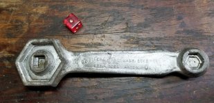

I found this ugly, bulky, forged piece of fat *** multi-wrench at the flea market the other day and it led me to a few discoveries, including the fact that we didn’t have a Ken-Tool Manufacturing Company thread. (We do now!) :)
Staying with the wrench, for a moment, it's kind of hard to read with the cadmium finish, but it reads "G-15" and "FORD AND MANY OTHERS" over "KEN-TOOL AKRON, O."
It nearly weighs in at 2 lbs (1 lb 11 ozs., to be exact).
My first thought was, ‘Not a wrench for weaklings’!
My second thought was that it wasn’t finished. There were no openings. I thought maybe it came off the line too soon, inadvertently, or as a reject, perhaps because it failed a QA check.
My third thought was, ‘It sure as hell looks like a drain plug wrench. But WTF was the company that everyone knows as ‘the tire guys’ (I mean, their slogan is “Wherever Tires Are Changed”) doing selling drain plug wrenches?
