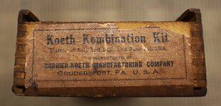

Here are two Koeth plier sets. The first set is in a box with the Currier-Koeth name on a label on the end. The second one is in a similar box but is marked with a printing on the top of the box indicating it was made by B.E. Hedges of Auburn N.Y. The tools themselves are the same except for the name markings. The first set has two sets of pinchers, large and small, and does not have the leather punch. The second set seems complete. Not real sure about the timelines. Seems that Koeth made them and was calling them Koeth's Kombination Kit (KKK). Next was the Currier-Koeth relationship. Not mentioned by either DATAMP.ORG or Alloy Artifacts, is the B.E. Hedges production. Found that Hedges was incorporated on Jan. 17, 1919.

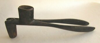

A couple of "specialty pliers".
- Ken-Tool Terminal Clamp Spreader, Reamer and Post Cleaner
- Blue Bird No. 20 Spreader

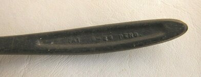

Gladly. Looks like "PAT 8-26 PEND".
Striking out at DATAMP for 08-26-???? And 08-??-1926. Ken as the company was also a miss. Only went back to about 1920 on the two items with open years
Wondering if that was an application date.
Only pliers seen were for ear tagging.

^ But they're not really "pliers" by definition. They are a "battery tool" used for cleaning the terminals on the battery cable.
So what did they call it on the patent document? "Battery Tool"? "Tool for spreading battery terminal"? :headscrat
That model @MisterEd posted appears to be lacking the half-loop thing at the bottom end of the handle for cleaning the battery terminal ON the battery like on this Indestro model 129:

Those markings look to me like they were done by hand with some sort of engraving tool. They certainly don’t look factory.IMG_7632.jpeg

I don’t think so, Don. I think your eyes are fooled by the oxidation. There are a couple identical examples in different condition with exactly the same forged-in Patent notice on WorthPoint, etc.
example
I casually searched DATAMP for Ken-Tool as a “company,” with no luck, then tried finding a matching patent by “pliers” category, also with no luck, despite finding three or four other battery terminal tool designs within a few years of 1926. My guess is the application was Aug1926, but the patent was not granted.
I actually didn’t find ANY patents associated with Ken-Tool on DATAMP, including 5343921 granted 1994 to John H Kusner - wierd.

I don't know what's going on with that "PAT 8-26 PEND" marking, but note that Ken-Tool was not formed until 1938. The Kennedy Tool Company was formed in 1925, funded by Cornwell, as a subsidiary of Cornwell, to make the rim tool its namesake, John A. Kennedy, designed and built. By 1938, the relationship soured, Kennedy split off to form his own company with a partner, but was prevented from calling it the Kennedy Tool Company by Cornwell. Hence, the shortened Ken-Tool was born. More info on that history with references and links (including one to Ken-Tool's history page) in the Ken-Tool thread, which can be found in the A-Z Index of the Sticky at the top of the forum.

Thanks for the link, LS. How about the possibility that the markings indicate patent pending with the number in the middle being a part number? Maybe the patent was never granted. It’s not like the tools are super common. Here are a couple of screenshots from the link. IMG_7635.jpegIMG_7634.jpeg
Edit…. Just spotted this example on eBay. IMG_7638.jpegIMG_7637.jpegIMG_7636.jpeg
39,160
Odd the Eprey example looks like "B-26" not 8/26... or is it a patent date with another patent pending? :dunno:
Isn't there a federal registry of patents applied for?
30,519
Jibes with the fact it couldn't be a year.
Legally, note that Patent Applied For and Patent Pending are two different designations. The latter means a patent has been assessed and approved, but not yet granted or assigned a number. I can provide textbook definitions later. I am NOT saying that means they used it correctly, or that we should find it. It would provide me a little more reason to look a little if I were looking.

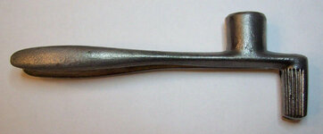

The B-26 example from a current ebay listing - clearly marked "B-26" - matches the illustration in the 1958 supplement No. 4, but not the illustration in the 1961 catalog No. 900.
The Worthpoint example (cited above by @LesserSon post #736) - matches the illustrations for the B-26 in the 1961 catalog No. 900, but not the illustration in the 1958 supplement No. 4. It also seems to match the illustration for the B-23 shown in the 1953 Catalog No. 50-51. This is also the case with another specimen from a 2021 ebay listing which is clearly marked B-26.
I am confused.
:headscrat
  • Ken Tool B-26 battery terminal tool (pat pent)(worthpoint 3775475211 03).jpg
  • Ken Tool B-26 battery terminal tool (pat pent)(worthpoint 3775475211 06).jpg
  • Ken Tool B-26 battery terminal tool (pat pent)(worthpoint 3775475211 07).jpg

I disagree - the B-23 grips are different from the B-26.
I do see variation in examples of the B-26, in the placement of the cups and prongs - coaxial or offset, which is likely a transition, either gradual from the B-23 to the B-26, or a synthesis of the two after trying out the new B-26 and finding some virtue present in the B-23 was lacking in the B26. It also appears some B-26 examples have a spring.
The placement in front or behind the pivot determines whether the cup or tongs open or close when gipped in the hand - coaxial position means that you would have to spread the hand or use both hands to achieve one of the two functions - the spring makes this easier. Offset position means both functions can be achieved by one hand closing, so no spring required.
28,611
I hope you're talking about the curvature of the handles (as opposed to "grip pattern") - otherwise you've completely lost me here.
I'm not trying to be thick - sometimes I manage to be thick without even trying.
And THAT is party the cause of my confusion on this one. (And your speculative statement makes perfectly good sense.)
And we don't have a physical example of the B-23 - only that catalog illustration, right?
I shot all this to datamp.org - not sure if I'll get a response any time soon. This one seems to be something of a puzzler, or maybe I'm just stupid. :dunno:

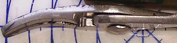

And this Bell System Plier(s) from F.E. Lindstrom that's 19 inches long! Resisting plunging in to the Bell System Practices Rabbit Hole.
