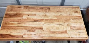

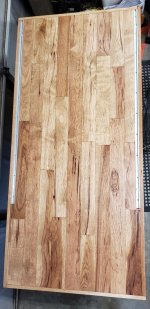

Pics of the progress in the last week. Filled in a few gaps with finishing epoxy and sanded it flat.
Then I had my son sand the top again for a final coat of oil...

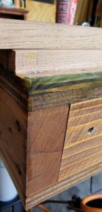

Then after the last coat of oil was applied and wiped down.
I drilled access holes for the T-track, then counter bored, debured, and polished them.
The top is still weeping excess oil out of the seams and larger open grain pores. Once that slows down significantly I will wax the top and buff it out.

And I'm calling it done.
