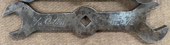

I don’t think this is what you’re looking for - square hole, not threaded.
Nope, dang it. Go figure. Thanks for posting. Consider the SK 1/2" x 9/16" yours regardless. I only have one other one and you're a lot closer to completing yours than I am mine. Think about the Crown exchange, too. I'm not anxious to have your two or to get rid of my two. I just completed an inventory after checking your inventory and it struck me that we each had complementary pairs as opposed to dupes, which doesn't happen too often.

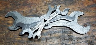

I'm going to split this up in two posts, one for NEEDS (to complete Partial Sets) and one for EXTRAS (available in trade).
NEEDS:
- Aetna - 5/8" x (3/8-24) x 3/4"
- J.P. Danielson VANADIUM Auto-Kit combo wrench with "batman" logo - 1/2" (box) x 9/16" (open)
- NEW BRITAIN flat shank offset DBE - No. 752 9/16" x 1/2"
- NEW BRITAIN flat shank offset DBE - No. 751 7/16" x 3/8"
- Script Indestro DOE - 7/16" x 3/8"
- Script Indestro DOE - 5/16" x 1/4"
- Ronson - 11/16" x 3/8"
Photos below of Partial Sets for positive visual ID of type, style, etc.
(A note on the Ronson set and why I need one for those who look and see that I have four (4) non-duplicate wrenches, and it was a 4-pc set. Something I don't think has come up before. If you look closer, you'll see I have two different 'top' wrenches in the stack. One of them is the one we're all familiar with. It has a 1/4" open end, a 1/4” square opening, and a 1/2” open end, with the Art Metal Works branding, the PAT No 942998 marking, etc. The other "top" wrench is similar, but it has a 3/16” square openingm and it's marked that way. Maybe for a different, later set. I plan to look into that, but haven't yet.)
I’m still away, but I had a more recent photo.
Would it be correct to assume from that statement that as was the case with Indestro, both the "Aetna" and "Crown" stamped open-end wrenches came in two different iterations: square hole for the purpose of using the wrench as a "T-handle" for a tap, and triangular/oblong hole designed for use as a thread chaser? :headscrat
The 3/16" punch-out on the small Ronson is a new one - I have never seen that before on any Ronson. The small wrench is usually the 1/4" square punch-out (for the "Presto-Lite" lamps) and that size is more often that not cracked at that point.
