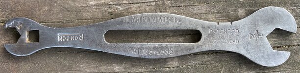

It's been badly mangled. That end is supposed to be a 1/4" open end with a 1/4" square tap opening just behind it. If you search Ronson in this thread or just scroll up to post #183, you'll see what I mean.

it's a weak point on that particular wrench - I've seen lots of them cracked/broken on Ebay. trying to find a replacement can be something of a challenge.
