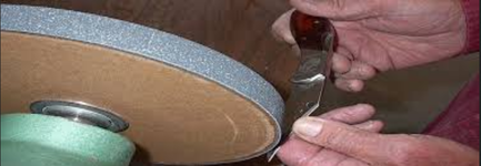

I currently have and use a Wicked Edge guided-angle sharpening rig to get and keep my knives terror sharp. Not a problem for me, as I never let them get dull.
The problem I have is when others want me to sharpen a knife--or five--that's duller than some of my hammers. With the WE set-up, it can take me an hour or more just to establish a new bevel from a bevelless blade.
I want to speed this up so I can possibly make some money from this, or at least be able to break even when sharpening friend's knives.
I'm considering two systems: Tomek T8 w/CBN wheels ($$$$) or a low-speed 2" X ? vertical belt, possibly water-cooled ($-$$$).
I just want to be able to quickly establish a bevel and repair edge damage, then finish on the WE system. Once I have a good bevel to work from, the WE takes minutes, not hours.
I should note that I've been putting scary sharp edges on knives by hand for some fifty years, but have gone to the guided system lately as my eyes and manual dexterity are no longer up to maintaining a uniform bevel. The WE fixes that for me.

Personally, I prefer to sharpen knives by hand and I have $500+ worth of diamond and ceramic stones and leather strops.
If the knife is a high quality custom knife, then using a grinder will cause some level of damage to it, even if you are an expert. Professional knife makers use grinders because of speed. It's like how a pro mechanic will use an impact, and a home gamer who cares about their old classic sports car might do everything by hand at the cost of it taking significantly longer.
If the knife is cheap, then go ahead and use a grinder. BUT the only way to get good at sharpening your high end custom knives by hand, is with a lot of practice. So I sharpen all of my cheap knives by hand, to get that hands on experience.
Alternatively you could just get a grinder to sharpen your cheap knives and then send your custom knives back to the knife maker to sharpen for you. Most will do it for free.
I dont think you can do a hollow ground edge by hand on a knife stone though, I think that requires a grinder. Possibly the same for convex but you might be able to get that with a lot of practice.

If you will be charging for your time and skill, then go with the Tomek T8 w/CBN wheels. Then your friends will become customers and no longer your friends....
If you want a cheaper option, get the vertical belt sander with an angle guide plate and a container of water next to it.
If you want the cheapest option, go with the MDF grit wheel on a bench grinder.

@oldschoolcraft : The bad bevels some commercial knives come with is a problem. I recently sharpened a brand-new Ontario RAT3, this one:
on my Wicked Edge. I was expecting to spend maybe a half-hour on it, just walking through the grits from 400 to 2,200, then stropping, but NO. The factory bevel was over 30 degrees per side--more than I could actually measure. That's more oblique than the edge I put on shovels! I settled on a 23 DPS bevel and it took an hour to establish it using a 100 grit stone. The Ontario steel is HARD. I was surprised, as I've owned and sharpened several Ontario knives over the years and always been impressed with the quality and finish--including the factoy sharpening.
But mostly I mean "that guy" who brings in his kitchen knives, which were last sharpened NEVER, but have been used to cut on stone countertops and ceramic plates. These usually have no trace of an original bevel on the saw-tooth edge. For these, I just advise that the owner buys a Chef's Choice and be done with it--just get them out of the shop. Even a couple of professional chefs have brought in expensive knives that were horribly abused. If I could establish an initial bevel quickly, I could have those properly sharp in less than an hour.
Friends who want their treasured hunting knives sharpened are just as bad, but seem to take offense when I tell them I have shovels that are sharper--and prove it. Again, establishing a good bevel quickly would allow me to not offend them so much.
But I really like the finish, shape and quality of bevels I can achieve with the WE system. So what I'm looking for is just something I can get a good, clean initial bevel, at a known, controllable and repeatable set angle in a few minutes, then take the knife to the WE for a finish.
So I want something with good, easily set guides/rests that will produce repeatable angles--either flat ground or convex (hollow) bevels so I can finish up quickly on the WE. This is one reason I'm looking at the flat belt sanders, as the supported, flat belt and some good rests should make it fairly easy to do what I want.
I've known a couple of custom knife makers and they all use a flat belt to establish the initial bevel. I guess I should have thought of that.
So I guess now the question is where to look for a good, low (pref. controllable) speed flat belt sander? New, used, or build it myself? Using a water bath instead of a wetted belt would be fine.

Kalamazoo 1SMVP is the machine to have
I have the 1SM and its pretty damn good.
A great young man and youtuber under "Steven Sharpens" used several in a portable sharpening system by reversing the direction and installing an angle block under the mount plate.
He convinced Kalamazoo to combine features of two different grinders and that begat the 1SMVP that you can adjust the angle and a longer and narrower platen for knife work!
Made in the USA as to boot!
He has three with two different grit belts and a leather strop belt but he is a pro. You can easily change belts on the kalamazoo and adjust tracking in less than 10 seconds

Thanks for those, Firebrick!
I like the TEFC motor on the Kalamazoo. Not only dustproof, but fairly waterproof. It's what we use for portable pumps in the brewery, and it would be safe to use a drip water system with it.
But I still need a rest to maintain the angles. That young guy was me... a long time ago. Of course, I was better lookin'!
Off to check out Kalamazoo tools....

There is an aftermarket adjustable angle rest for the 1SM but my memory fails me as to the company name. Its sort of odd as the belt remains going down and you stick the knife in and pull to the side. Not my cup of tea but several others on the knife forums liked them.
Wolverine? I don't like the idea of pinching the blade between the rest and the belt, either. Too easy to scratch the blade. Edge following is the way to go for that.
As for belt direction, if Kalamazoo could do it, it means the motor is reversible (pretty sure it's a common Dayton motor). A DPDT switch would do the trick of making it work either way. Not sure what they had to do to make the tracking work, but that kids one sure doesn't seem to have any extra parts.
Aww, hell. I can just build one myself for a few times the price of that one! It probably won't look as nice, to boot!
It wasn't wolverine, I know them by their wood lathe turning tool jigs for grinders/sanders. That is the reason I don't try one as well and why I just set it against an angle block and carry it over to the belt.
It came to me, a Kally rest.
Mine at least but I think all the Kalamazoo's have Baldor's. You do have to adjust tracking if switching direction but the its so easy as you just loosen the knob and twist the top shank/pulley/guard till you get tracking where you want it and retighten the knob. As the motors come you have to rewire to switch directions but yes, a proper switch and it could reverse.
Anyone near here got a spare treadmill?
Ironically I was thinking of making something as well, but came across a review. They are simple and yet sturdy and good sanders. Its much slower than a standard belt grinder so its much less likely to burn the metal.

I already have a fairly nice rest for a bench grinder that would probably be pretty easy to adapt to use with a belt.

I have the T8. I solved my sharpening woes forever. I even splurged for the japanese waterstone finisher.
But it's just not as easy as throwing money at the problem. The Tormek still requires some skill to use and get great results. Because it's a slow speed machine, it's a slow grinder. Which is great for preserving temper and gentle to tools. But the Tormek is not the tool to reprofile and thin out a fat edge.
If you just want "yeah, that's pretty sharp" (say 150 BESS I'm guessing) You can get that easily on the T8 and it's almost fool proof.
But if you want elite level sharpness, you can park at the T8 all day and find that right as you think you're about to pass into nirvana you end up ruining the apex and you're back to the 150 range or so you started with.
I'm excited to have the TOrmek but disappointed that it wasn't the easy button to have super sharp knives without skill or massive time investment.
