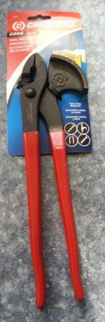

I have a few Knipex pliers, all have served me well. For pulling nails, I've had really good luck with Crescent NP-11 nail pulling pliers

End nippers would be the right tool for pulling nails, not dykes. That being sad, I would think they'd handle pulling finish nails without trouble.
