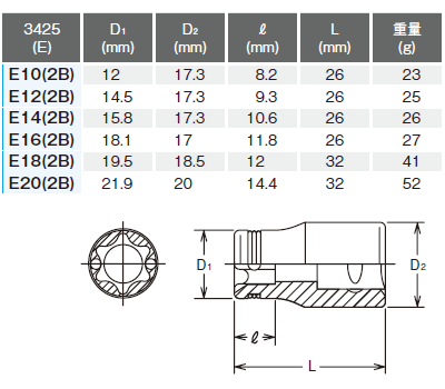

Has anyone on GJ used the nutgrip torx sockets from ko-ken? I SWEAR I saw a universal joint set of koken nut grip torx in a catalog somewhere a while back, but they dont list that in their catalog, so maybe Im dreaming, or maybe they just stopped making them...
Anyway I have interest in the nutgrips in metric and in E-torx.. IF anyone has stories to tell about these sockets, please let me know if they are worth it/not worth it
I work on BMW and the aluminum Etorx oil pan bolts etc can be a pain
I have the E12, 14, and 16
Just used the E-12 this past week to do a transfer case.
They do work fairly well. Compared to regular nut-grips for hex fasteners, these require a bit more attention by the user to ensure you are properly engaged with the fastener. E-torx fastners can have differing dimensions too, so on some fasteners the holding power is less and so requires a bit of finesse to ensure you don't drop the fastener.
I really wish they could expand to include some 1/4 drive sizes in E8, 10, and 12
