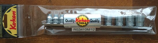

I either received a wrong set or I accidentally ordered wrong type of sockets from Ko-ken. I was trying to get a regular 6 point set. The deep ones on the left are usual "flat drive" and the regular ones on the right are "surface drive"
- Does anybody have any experience with surface drive - is there any benefit of it?
- Is surface drive much more likely to damage/strip the bolts (I live in MA, roads are salted...)
... I am not sure if Koken USA will agree to exchange them or accept the return - just wrote them a letter. Original order was from November 2024, they just came in...

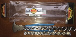

Here's a few pics of the actual Koken set I used for the above test. One of the really nice features is the metal case.
The knurling on the extension bars is great - it means with one hand you can twist it with your greasy fingers until it starts to get tight. Try that on a smooth chrome finish :)
