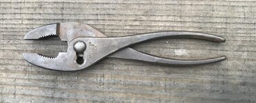

Picked up these GripKut Junior pliers yesterday. Lugz provided some info in the Garage Sale thread and stated he couldn’t find any posted here, so now there is 😂
Trying to figure a date range on these is a bit confusing according to the info provided on Alloy Artifacts.
The handles have the “Don’t Slip” pattern, and are marked “Kraeuter USA” inside. They also lack a location stamping.

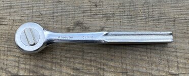

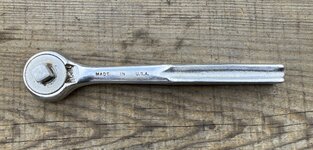

Years ago thought I bought a set of SK deep I/2” drive sockets on eBay, but what arrived were these. Price was good, and they seemed good quality, so I kept them.
Tim

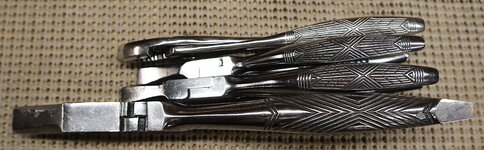

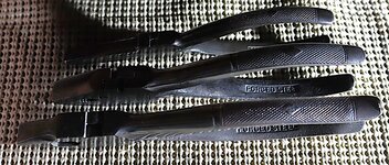

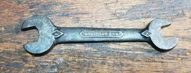

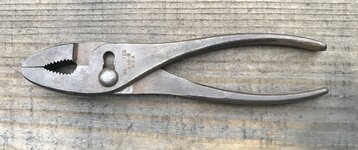

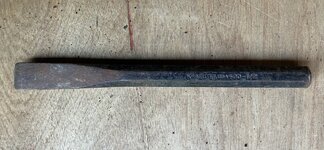

Here are my Kraeuter pliers. The first one is marked "Kraeuter & Co Inc, Newark N.J., Pat Pend, U S. Have not found a patent per say, but maybe because it can use the same casting for both sides? Next are a group of three with "Forged Steel" inside the handles. Includes a 1831-7", no model 6 1/2", 1741-6. Next group of four marked Kraeuter USA inside handles, 1821-8, 601-5 1/2, 1601-5, 356-5 1/2, Last is a group of three also marked Kraeuter USA, 1611-5 round nose, qty 2 #82 end nippers.

356-8

Here’s a recent pick-up:
A Kraeuter 2801-7 7” linesman pliers. Its face is marked “Nickel Dreadnought Steel”, which AA says the company introduced in 1914. It does have the “Don’t Slip” gripping pattern.
30,776
I found another Diamond-K engineers' wrench (A1619) that I needed at the flea this morning. Photos attached.
Updated collection list...
"S" wrench
B1214
B2022
B2428
B2832
Engineers
A1416
A1618
A1619
A1922
A2428
A2831
Checknut
C1214
C2428
Tappet
O1416
Kraeuter 14 piece 1/4" drive SAE Socket Wrench Set w/Original Box
manufactured by S-K Tool Division of Dresser Industries, Franklin Park, Illinois U.S.A.
this set includes:
31106 3/16" 6 pt std socket
31107 7/32" "
31108 1/4" "
31109 9/32" "
31110 5/16" "
31111 11/32" "
31112 3/8" "
31114 7/16" "
31116 1/2" "
32031 3/8" m x 1/4" f Drive Adapter
31054 6 inch Spinner Handle
31061 2 inch Extension
31070 RHFT Reversible Ratchet
Steel Box w/plastic insert
Set A
@four.cycle , were you able to find this set in a catalog?
29,377
No.... that was an ebay purchase. Had a buggered handle on the spinner. Had to buy a new one for that set.
I don't think we've ever seen a "new" Kraeuter catalog - only old ads for early pliers.
The most recent catalog ITCL has is 1960, and there are no sockets or ratchets in it at all.
29,377
so... that one of mine (in the box) has an extra piece in it: the 3/8" F x 1/4" M drive adapter.
I think I have another Kraeuter set that's just sockets and the ratchet - no box, no extension, no spinner handle.
