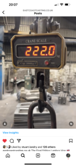

So now the mk 2 which has a 18” opening
No finished pictures yes as it’s not fair on the customer as he wants to show it first and I need to finalise some bits
Please note scale is in kg not pounds , do your own conversion!
