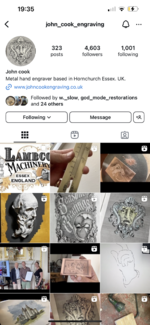

A local engraver has designed this for me . I’ll get a printing plate made and make a simple printing press so my next vices will have authentic old school paperwork with them
