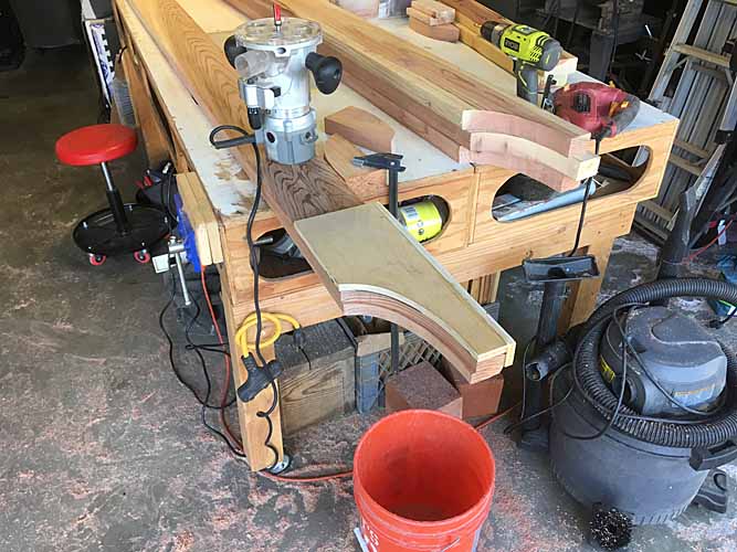

rayra
Dec 1, 2014
4,724
Escaped from Los Angeles
Build a Ron Paulk -style truss box workbench top.
I paid his low asking price for his blueprints, they were very useful. I then modified the design to suit my purposes. I already used a large rolling table and had embedded my router table in it.
I built my version of Paulk's portable workbench, two long narrow truss boxes and surfaced them with the melamine-coated particle board of my old table and also cut down the leg height of that table to maintain a height match with my table saw so the rolling work table still serves as a feed support.
the other big benefit of the Paulk truss design - besides its rigidity over its span - is that it creates an under table, where you can set all the tools you are currently using, so the table top remains uncluttered.
The plain table -
and the later modified-Paulk table with a similar-design storage drawer / platform for my Suburban, then in progress.
Doesn't really showcase the table very well but conveys the general multipurpose idea of it.

my current table is two long modules each 21" x 84", slightly downsized from my last, which was 44" x 97" IIRC.
With a box-truss design you can make your table about any size you want and deck it like a roof. Or laminate two thin staggered layers and make it as big as you want. it you are wanting to lay out sails or something.
