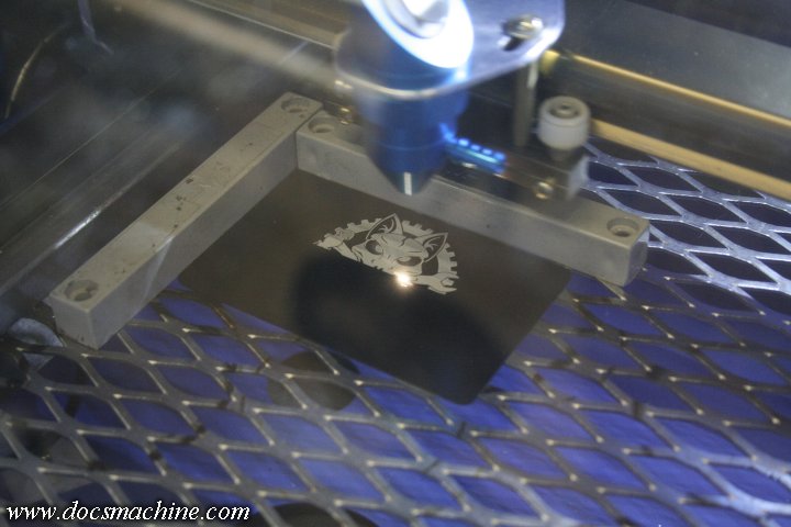

The typical setup when using K40 Whisperer is to pair it with a drawing program called Inkscape- both of which are free downloads, by the way.
In my case, I find it a lot easier to use a bog-standard graphics program to draw my initial item as a standard black-and-white (no greyscale) TIF image.
Of course, that's mostly just cosmetic things, logos and the like, rather than anything requiring precise dimensions, but there's ways around that too.
You run the TIF file through Inkscape which converts it to a Vector, and that Vector file drops right into Whisperer.
Doc.
For a workflow that seems horribly inefficient.
-It is not in the least.
Yes, you can draw or import an object directly to Inkscape, but personally, as I'm already very familiar with the graphics software, I find it easy to import/draw/modify/etc. the image in that.
My workflow is draw, save to folder, open in Inkscape, convert to Vector (about five mouse clicks) save to folder, open in Whisper, burn.
Takes way longer to draw/generate the art in the first place.
Not saying Ink/Whisper is the best solution, I don't have enough experience with other options to be able to tell. But, I can say I knew zero about running a laser engraver before I bought one, and this software has been easy and intuitive. The only problems I've had have been due to my inexperience.
