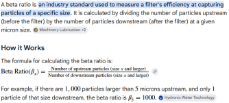

I think maybe the amsoil filters do at 20 microns? Also what is meant by the beta ratio exactly? Wix catalog lists for there 51056 that it has a nominal micron rating of 21 and that the beta ratio is "2/20 = 6/20". What exactly is the meaning of this? From AI
So if there are 2 particles upstream before the filter and 20 particles after the filter... obviously not the meaning of "X/Y" in the WIX data.
You have to stop looking at AI, as It only gave you half the of the answer and a chart does just fine in showing what you need to know
I don't know why but the "2/20 = 6/20" has to be a typo. A beta 2 @ 20 microns make perfect sense, but a beta 6 isn't a thing that people use in the industry and can not have the same 20 micron a the beta 2 number.
