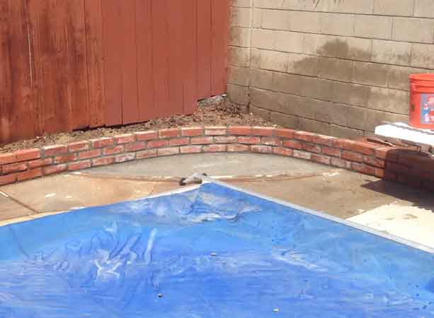

/grandad was a mason / bricklayer in the Imperial Valley. He taught my Dad some before my Dad joined the Navy. They both taught me and I was child slave labor when Dad retired from the Navy and we got our first house(s) of our own. I still do my own work. About to lay a brick patio this winter.
Here's a backyard corner, took out an overgrown palm tree and reversed the curved brick of the original layout. Cleaned and re-used the original brick as I couldn't find anything that matched. Small job, matching two different levels, house is nearly 50yrs old, things shift over time. Made it all work. A small job. All the big ones were before digital cameras. Too old for that **** now. Or not quite, supposed to lay ~30' of slumpstone retaining wall for my folks this Fall, too.
That's all I can think of off the top of my head. If you have more questions PM me,

A properly bonded joint, the brick itself will break, instead of the mortar cleaving off / popping loose.
Sorry, but if you think the mortar should be stronger than the masonry unit, there's no point in me wasting my time on you.............
-I got the little 1 1/4 harbor freight mixer and it worked ... not well though.
-I struggled the most with buttering the sides, no matter what consistency I had I really couldn't get the mortar to stick to the sides well
Concrete mixers don't work very well with mortar, they don't "fluff" the mortar enough and introduce enough air into the mortar, so it's not nearly as workable.
As for buttering the ears, try "priming" the ear first by holding the trowel flat to the end of the block and getting a little bit to stick for the whole height of the block. Then, hit it with the trowel at about 45 degrees with more mortar.
I might have missed it, but what kind of mortar are you using? Almost everything pre-mixed from HD is way too lean on lime in my experience.
