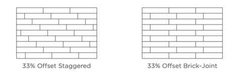

I'm getting ready to tile a kitchen backsplash with 3"x12" x 5/16" thick wavy subway tile. The instructions say NOT to overlap by more than 33% when using a brick pattern.
I think the main objective is to get some type of symmetry around the most visible showpiece in the kitchen - the stainless steel range hood and the flue. Then to avoid little pieces (less than 3" long) anywhere in the installation. Is that a proper approach?
I started calculating some layouts for a 33% offset brick joint (see pic below). I began from the end of the peninsula and worked my way toward the inside corner.
Am I better off marking a line down the center of the range hood and figuring out my layout from there? Tile layouts are always confusing to me.

Usually the 1/3 overlap is because the tile are not flat and have a little bow in the middle. This is to reduce lippage. Lay two back to back and see how bad they are. If not bad, I would lay them how ever you want. I have ignored that 1/3 overlap even on floor tile if they didn't have much bow and they came out fine. Personal preference, but I like them laid like normal brick on a backsplash.

I personally typically do the offset staggered that you listed. That is pretty much how I always do it.
Layout is very subjective. If you want to center it on the range hood area and as long as you don't end up with a really small piece at the ends I would say go for it. I try to shoot for around a 1/3 a tile as my smallest piece in a case like this.

I prefer normal (1/2 overlap) brick layout as well. heres the bow. Looks like less than 1/16”. Is that too much for a kitchen backsplash?

I've gone as far as drawing kitchen (or bathroom) to scale and overlaying a scale drawing of tile over it to visualize how everything looks and figure out where the off cuts land. In general I prefer to start layout in center and work outwards both directions for symmetry but that's not always the best option regarding off cuts. Range and hood area are typically main focal point you should do everything you can to make sure it looks good there. Off cuts aren't just issue at ends of run you have to pay attention where any transitions such as range or sink work into layout you should avoid any small pieces especially in those high work / high visibility areas. Subway tile can be laid out like traditional brick, in thirds or even stacked vertically it all comes down to personal preference. I generally try to have whatever pattern flow around corners, so if you're doing a traditional brick stack and have a full tile run into corner, the one next to it on adjoining wall should be a half tile. Visually this makes it appear the pattern continues around room. Pay attention to the vertical lines on alternating courses you want them to be dead straight up and down I've seen pattern drift off course either due to carelessness of installer or because starting wall was not perfectly plumb and it throws the whole room off. Run a laser vertically to keep courses on track if you have one. Good luck!

I like to center from the main focal point entering the kitchen. then do a layout to see how I can get the most length of cut tile on the next focal point end wall. I have also "cheated" an inside corner under a cabinet to get a longer tile on a doorway end wall. If you cheat anyplace on having a shorter lap do it on inside corners under cabinets as it is much less noticeable in my opinion.
Layout is subjective and has to please the person who looks at it everyday and is paying the bill!!
