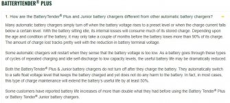

Anything like that can have a risk, it could cook the battery or it could even start a fire. I think the idea of a timer is great, then you get the maintenance and have minimal risk. Then of course the timer could fail and cause the same problems.
Minimal risk.. by adding another device? I don't see the logic.
And the manufacturer already points out in the FAQ above that cycling the charging off and on decreases battery life.
So you have added complexity and reduced efficiency.
